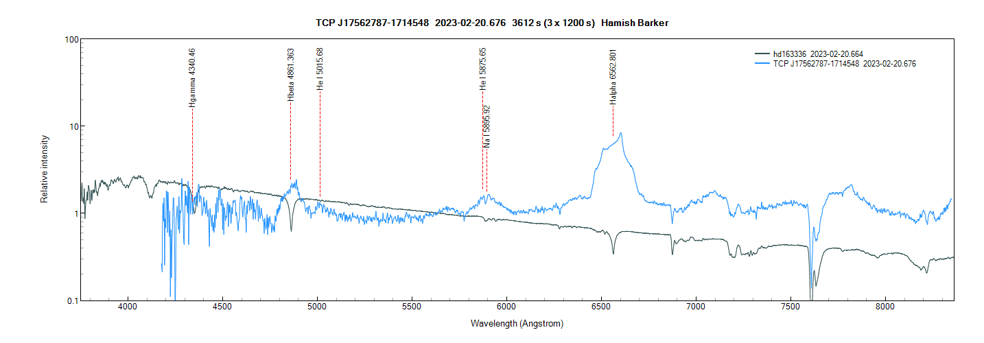

I took a spectrum this morning also. H alpha is massively broadened. Elias Aydi went so far as to describe it as "wild".
Dr Steve Shore was kind enough to have a look and has made the following comments:
" the spectrum shows a reddened continuum and strong emission with a heavily broadened base in hydrogen Balmer lines and in He I lines at 447.1 (weak), 501.6, 667.8, and
706.5 nm, all consistent in width with H-alpha. No profiles show P-Cyg absorption.
The H-alpha HWZI is 5500 km/s. The Balmer ratio Hbeta/Halpha ratio seems to be consistent with the Lyman lines still being optically thick but the lack of absorption suggests a low ejecta mass. The H-alpha line shows emission peaks at -2060, 1740, and 4200 km/s, the red wing is blended with He I 667.8 nm, typical of a complex, possibly axisymmetric ejetion. The spectral features and radial velocity are consistent with the object being a very rapidly evolving nova after visual maximum, possibly a recurrent or an ONe system. Spectroscopic monitoring is needed for this."
velocity-halpha-hd163336_20230220_664_Hamish Barker.png (16.82 KiB) Viewed 8868 times
