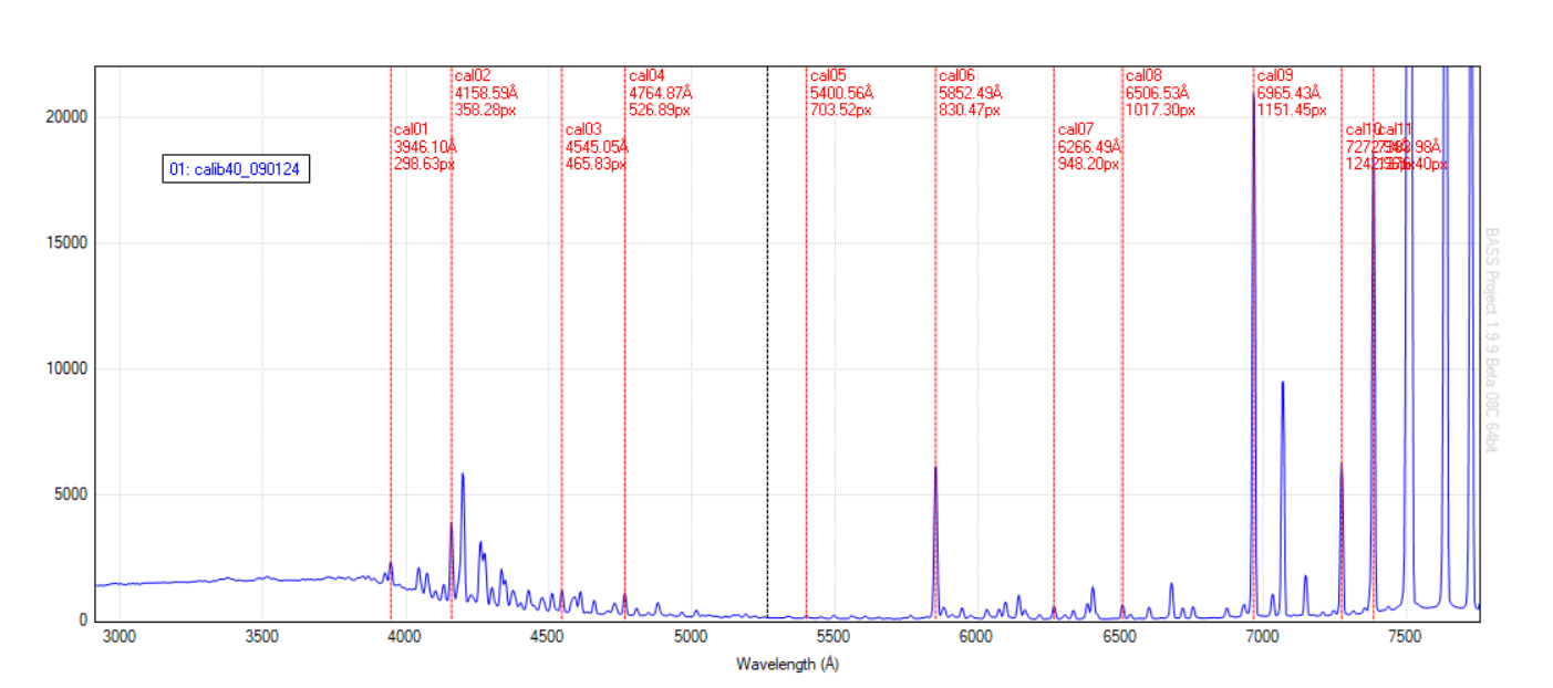

Thanks for the work to recover this site, it's great to be back. Here are my Relco calibration details:
Spectroscope: Alpy 600
Calibration lines:
7383.98
7272.94
7147.04
6965.43
6506.53
6266.49
5852.49
5400.56
4764.87
4545.05
4158.59
3946.10
Degree 4 polynomial
Hugh

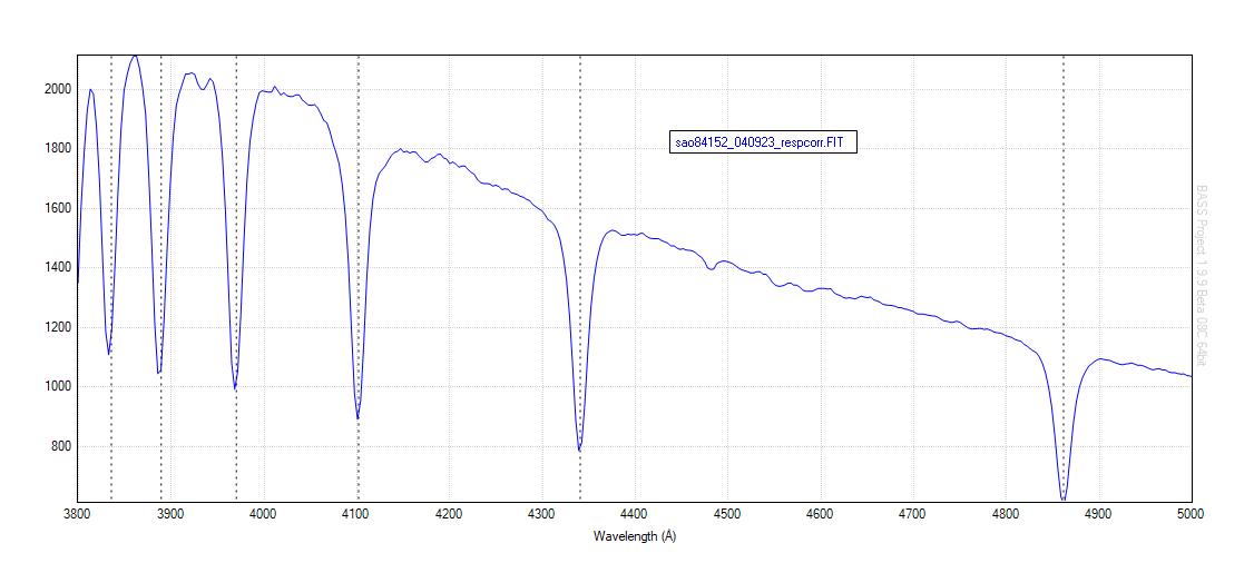

John Coffin wrote: Sun Apr 21, 2024 6:51 pm Hi, I am using an Alpy 600 and have never been able to get an accurate calibration during the six years I've been using it. I normally use ISIS but have switched to Demetra to see if that made any difference. I have played around with different degrees of polynomial and various calibration lines. In fact I used Hugh's list and that failed to calibrate at all. With a 4th polynomial the RMS was 0.22
Hi John,
An RMS of 0.22 is pretty typical I find, and I think an RMS of this value is typical for other users as well and shouldn't significantly affect the accuracy of your calibration. So I wonder what is behind your comment that your calibration using the same lamp lines 'failed' - could you give an example? As a typical example from me, here's the calibrated, response corrected reference star spectrum (zoomed into the blue end) that I used for a TCrB observation made last year. It does show the same slight blue shift error towards shorter wavelengths on which both you and Robin have commented. But the error is very consistent and so doesn't affect the capability to make accurate comparisons of different star spectra
Hugh
