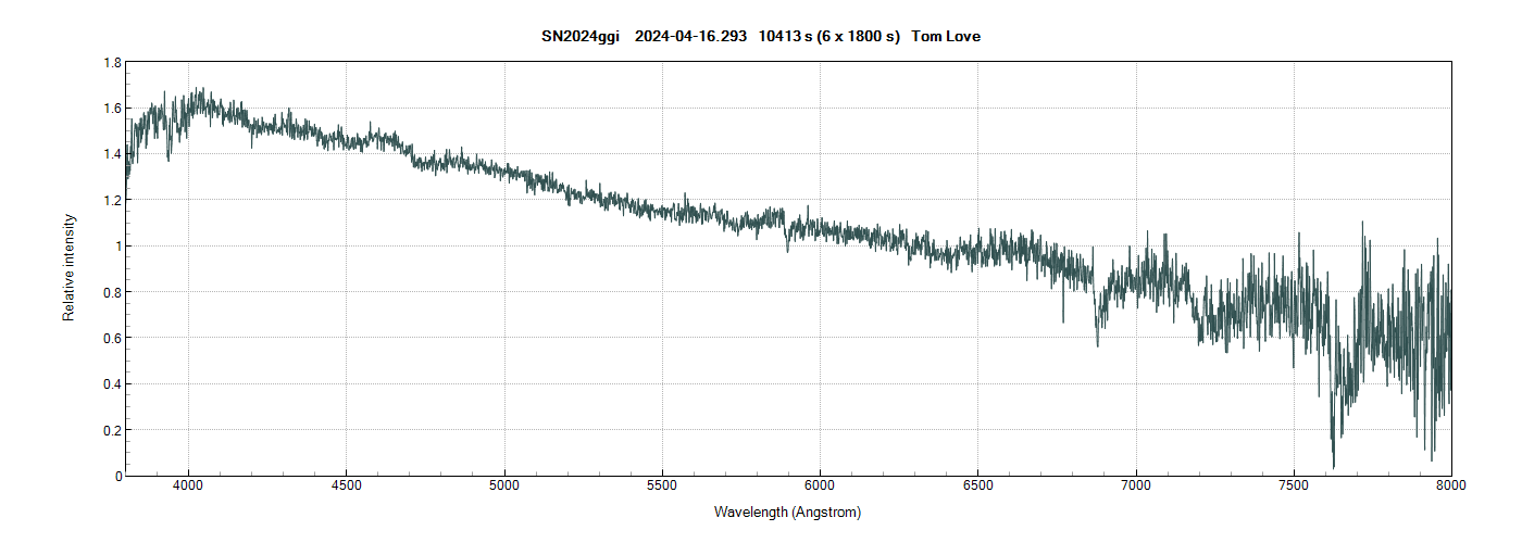

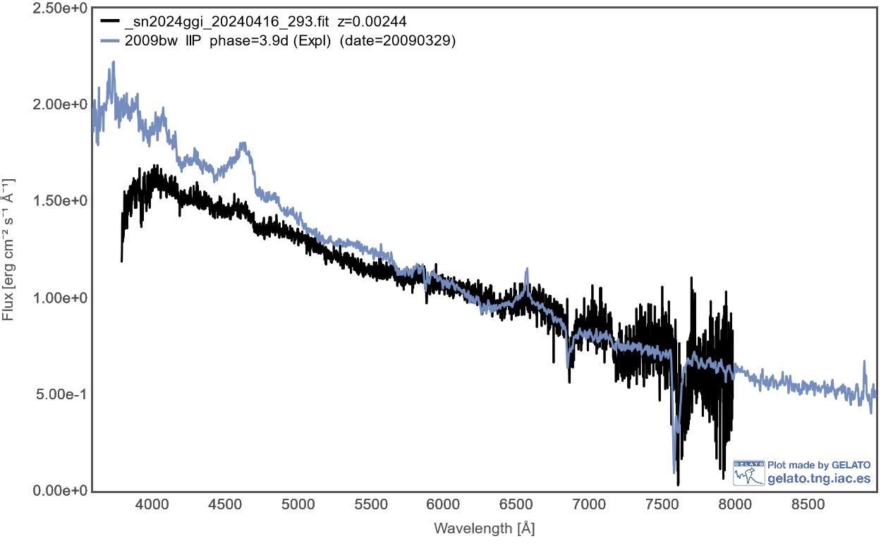

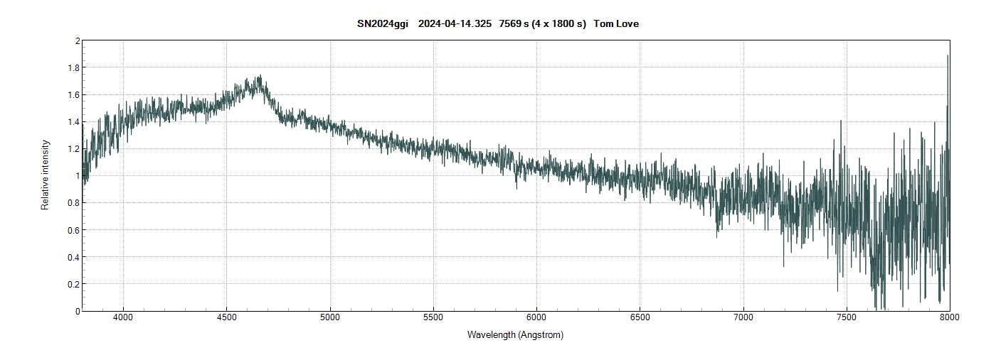

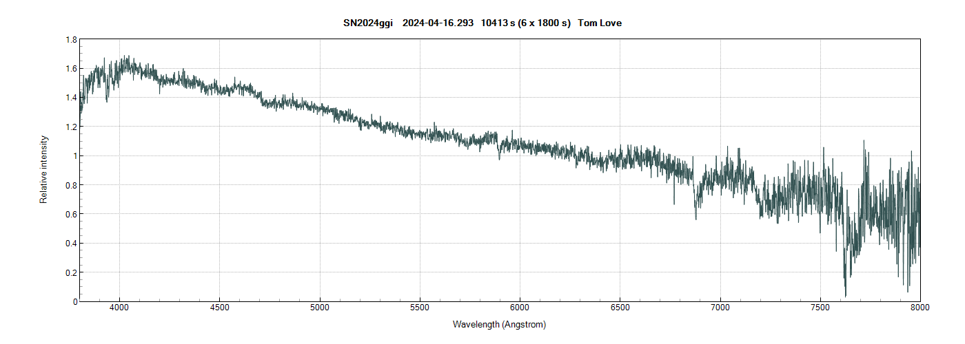

Well, the weather has been a little more cooperative in New Zealand. I got a spectrum on Sunday (though a little compromised by high cloud), and one on Tuesday night. GELATO classifies them as unreliable Type II, which is probably about as good as I can hope for.
Comparing the more recent one to a GELATO spectrum shows some possibly similar features, but very buried in the continuum.
Re: SN 2024ggi a nearby type II supernova in NGC3621 (Dec -32 deg)
Good try Tom !
Type II can be almost featureless at this stage. It will probably develop with time though. Compare with SN 2023ixf for example
week 1 https://britastro.org/observations/obse ... 5370c08912
week 2-3 https://britastro.org/observations/obse ... 4d96087a30

Thanks Robin. On Sunday I initially thought I might have pointed at the wrong object, but eventually decided it was about right for an early Type II. The forecast for the coming week here is pretty good, so will hopefully capture some structure as it emerges. I've just kicked off another exposure a few minutes ago.

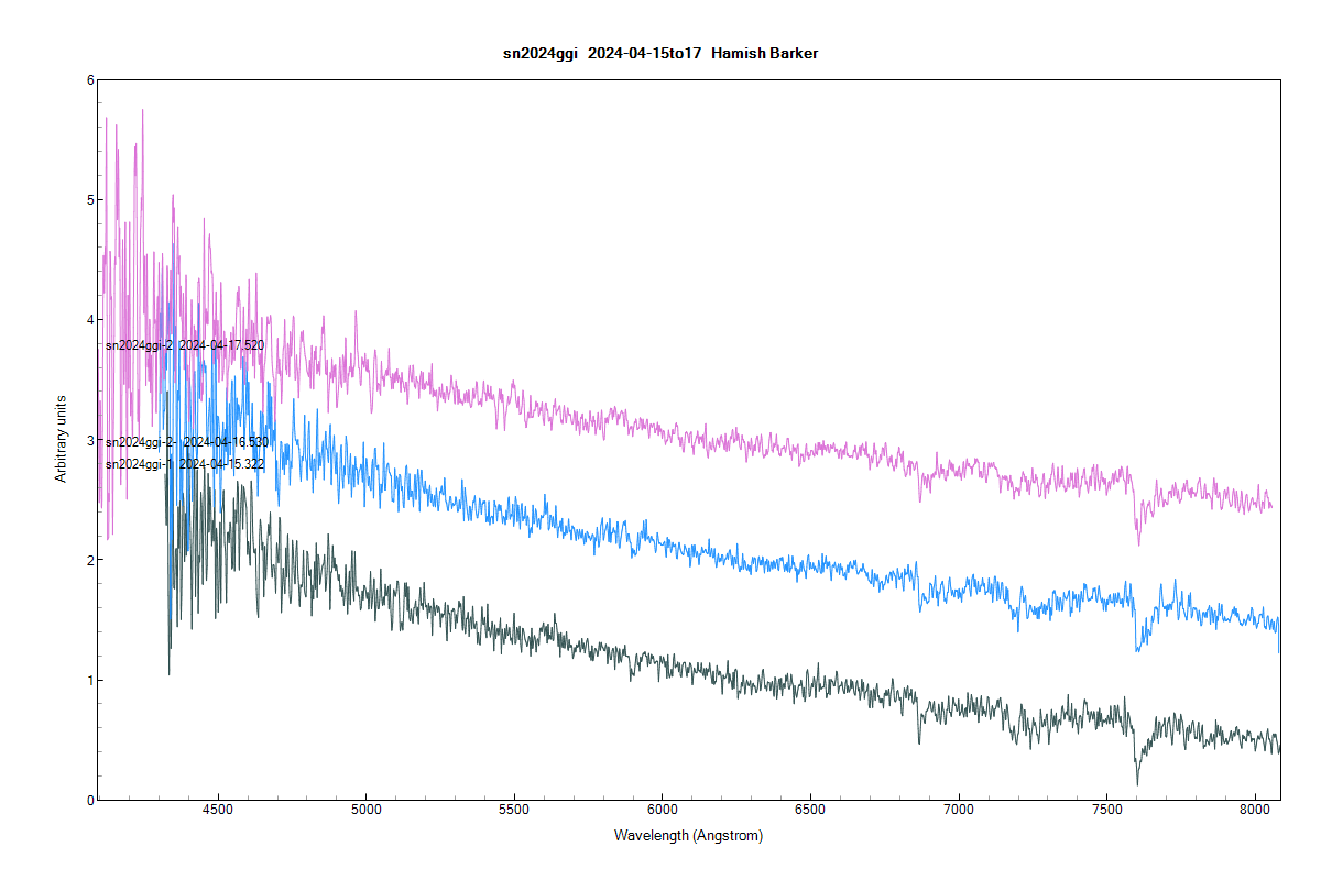

A few more from this week.
sn2024ggi-1_20240415_322_Hamish Barker.png (153.97 KiB) Viewed 35689 times

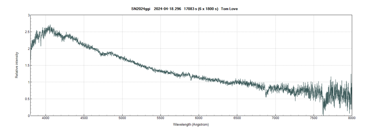

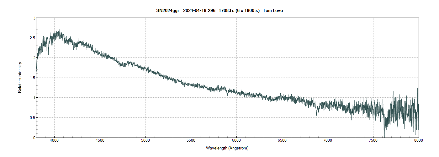

Not much in the way of structure emerging tonight.

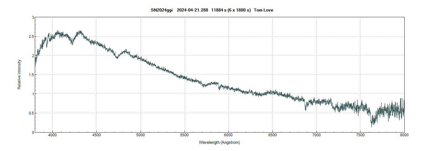

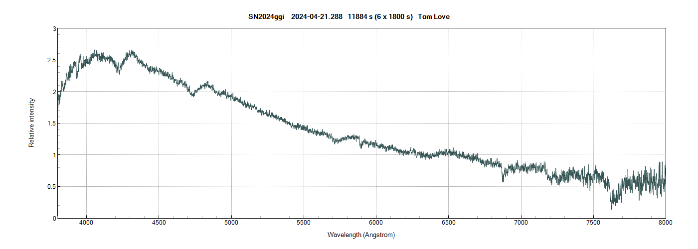

Structure starting to emerge.

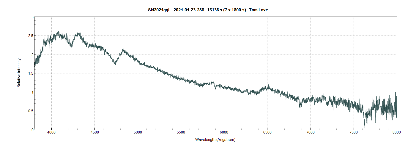

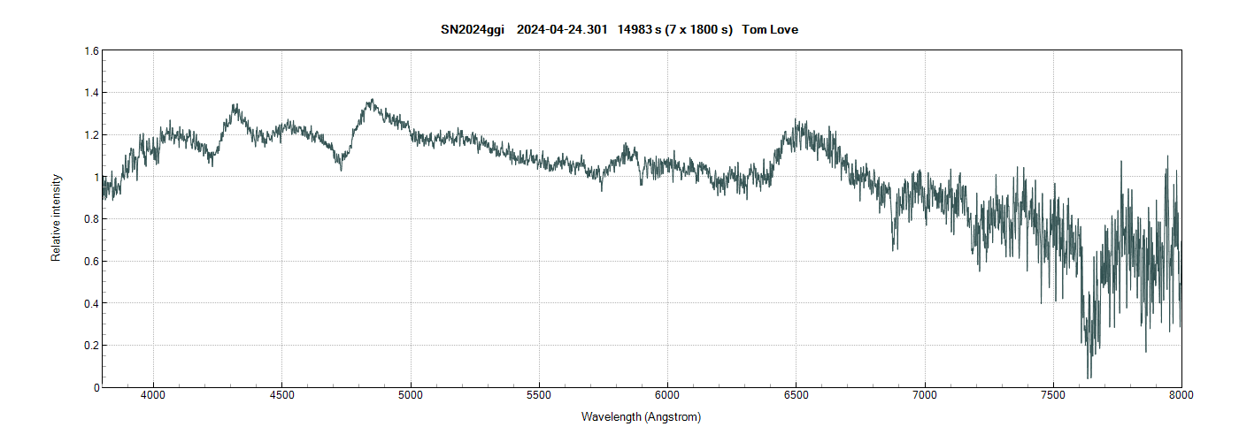

And more structure. A bit noisier, though, especially at the red end. Whether down to terrible seeing (it was awful), moon , or what else I'm not quite sure.
The next few days are not going to be favourable for observing, so perhaps more over the weekend.
