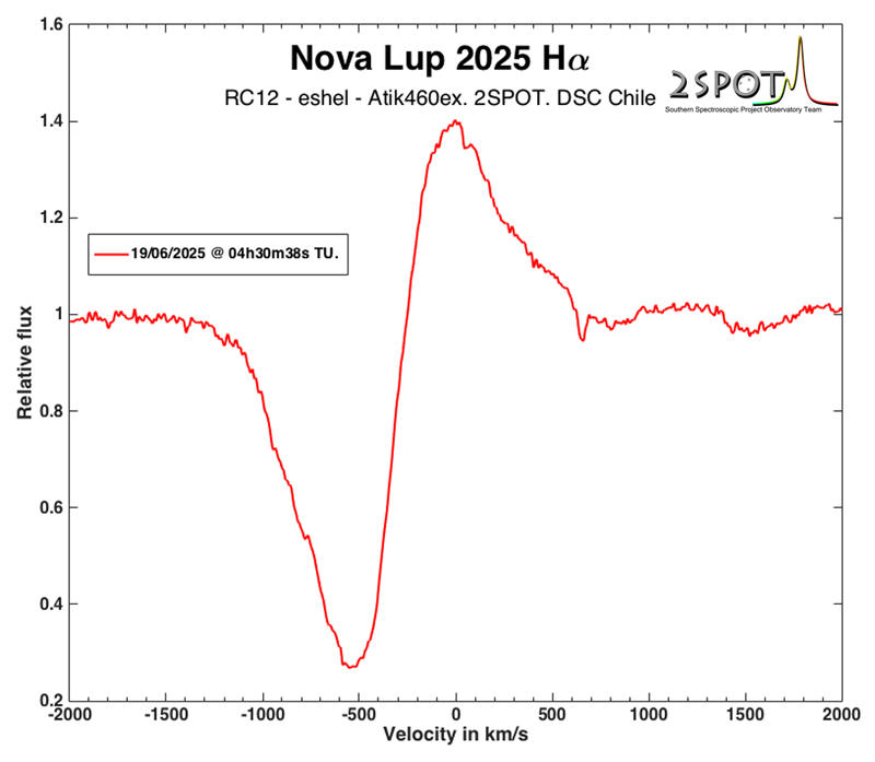

Here's a spectrum of this Novae taken this morning from our 2SPOT setup in Chile and an eShel spectrograph (R=11000) 5 X 1200s.
The raw spectrum of one exposure

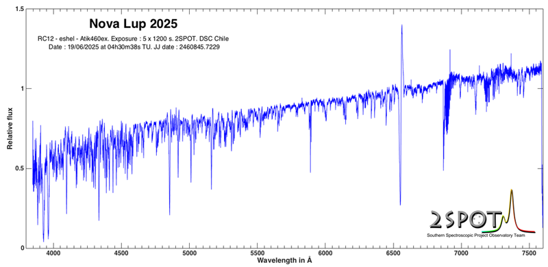

The full graph from 3900 to 7600 Å

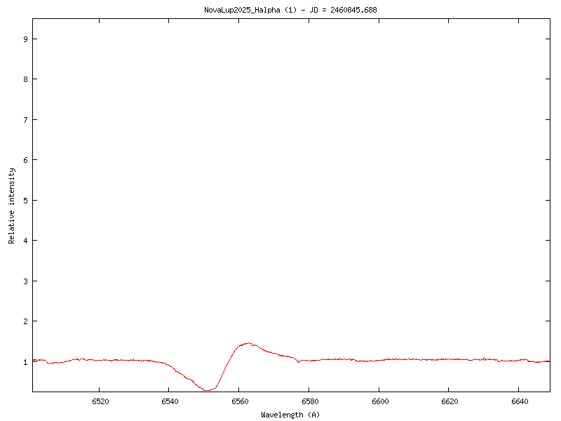

Detail on H alpha line to mesure the ejecta velocity

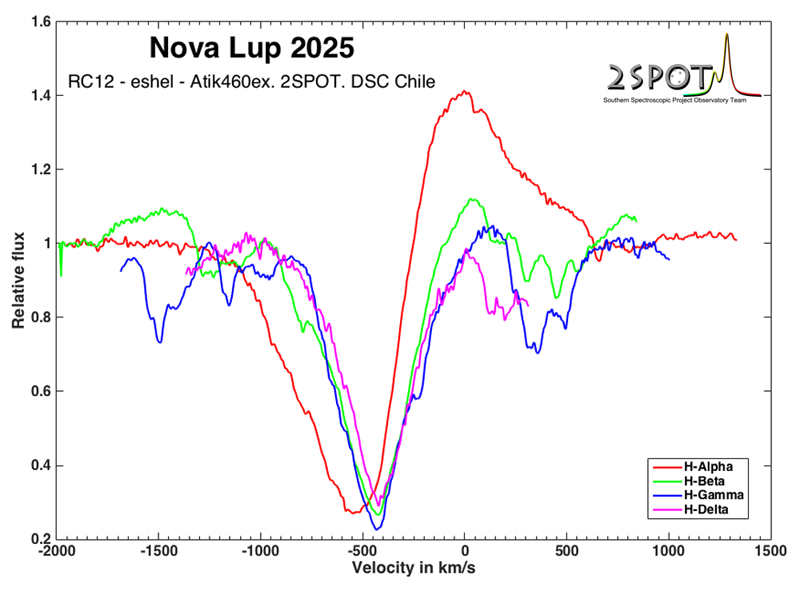

And all Balmer line velocity comparison
The Nova is very bright and easy to take in medium resolution

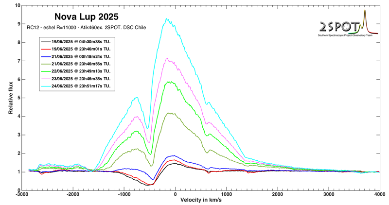

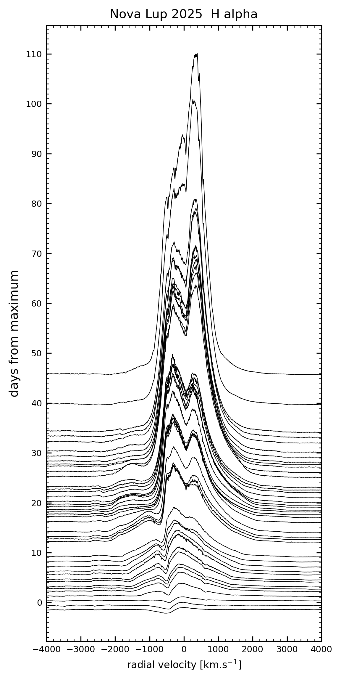

Evolution of this nova in 7 days on H Alpha line
and an animation with our spectra

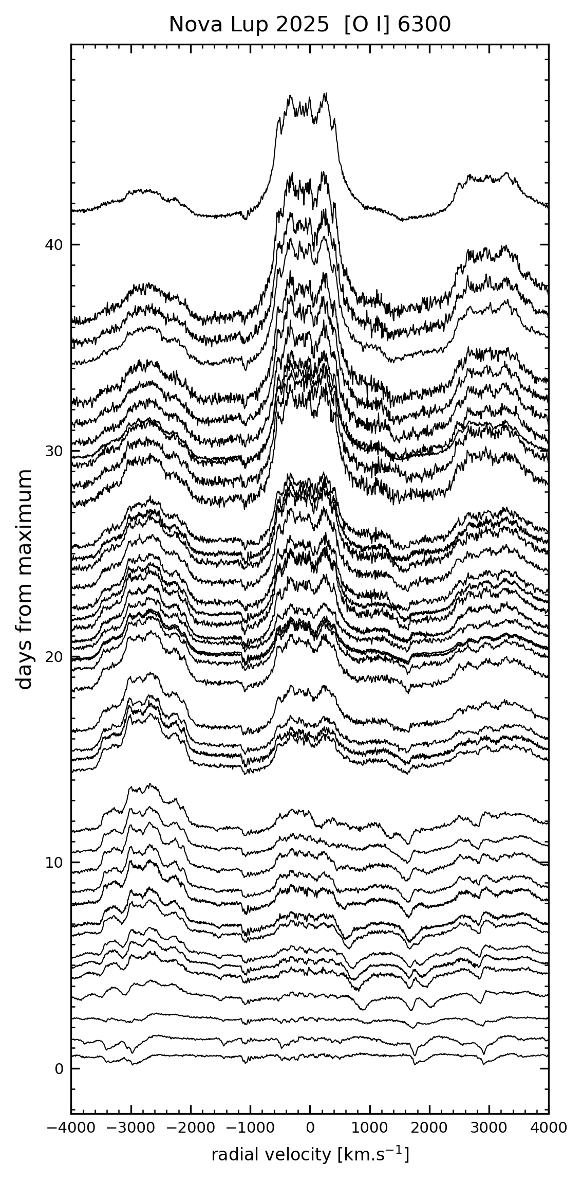

Great monitoring.
[OI] 6300 is now obvious, classical evolution during the decline.
Spectra on: https://aras-database.github.io/databa ... p2025.html

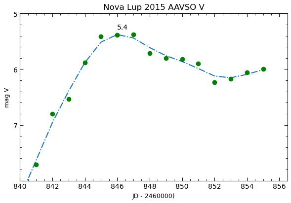

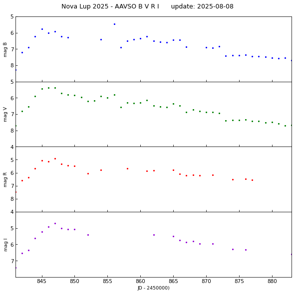

Light curves from AAVSO observers:
Re: Nova Lup 2025
Perhaps a rebrightning:

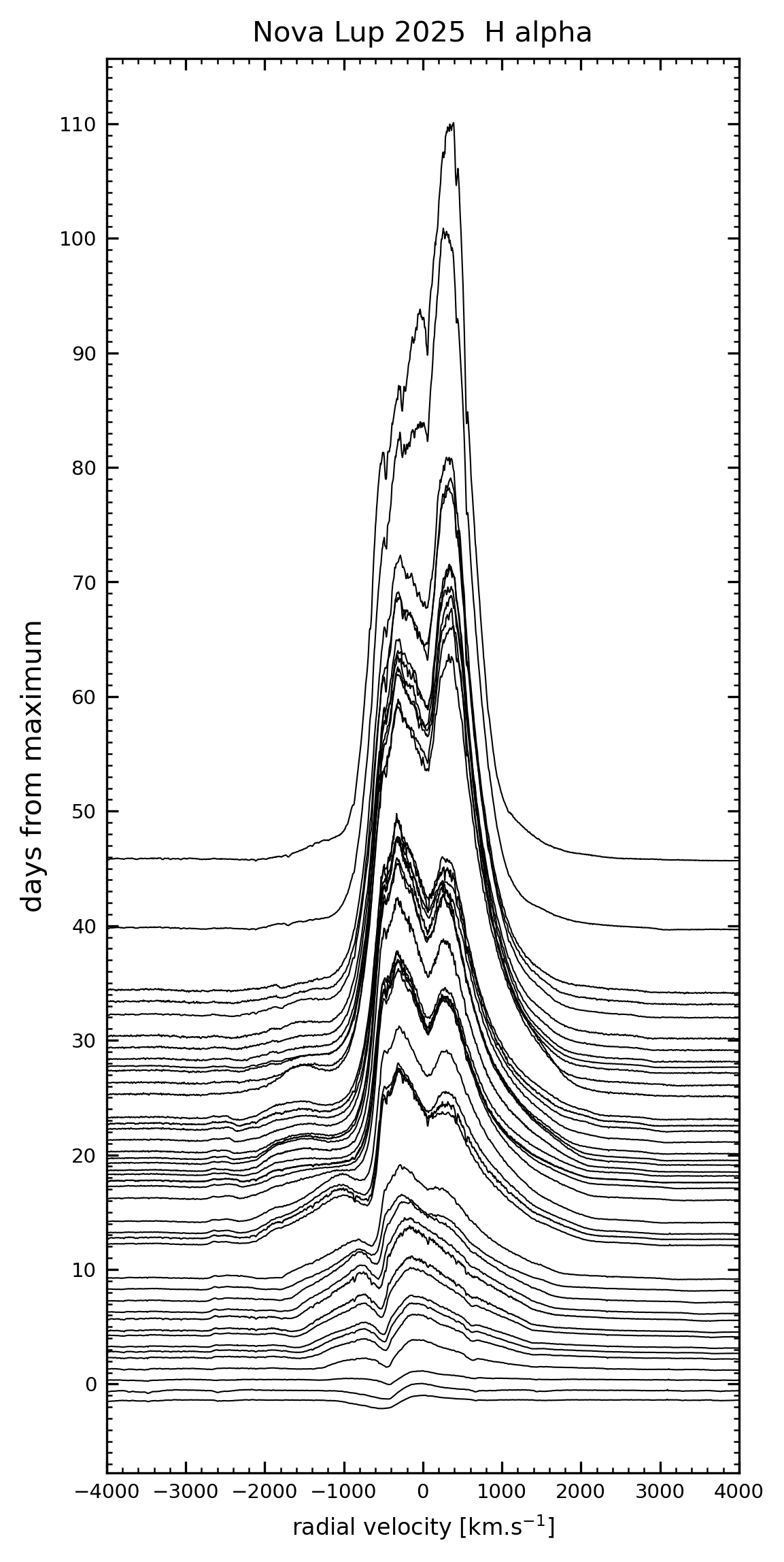

Our 2SPOT team continues to follow this nova from Chile with an eShel spectrograph (R=11000).
Here's the evolution of this nova on the H Alpha line with the 21 spectra we've made to date

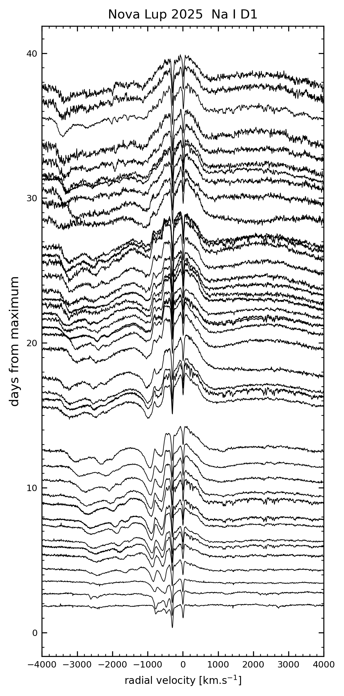

And the evolution of the D1 D2 lines and the Helium I 5876 line

[O I] line in spectra secured by Team 2SPOT, Colin Elridge, Paul Lukas
The spectrum is evolving toward the nebular phase
Spectra (76) in the database: https://aras-database.github.io/databas ... p2025.html

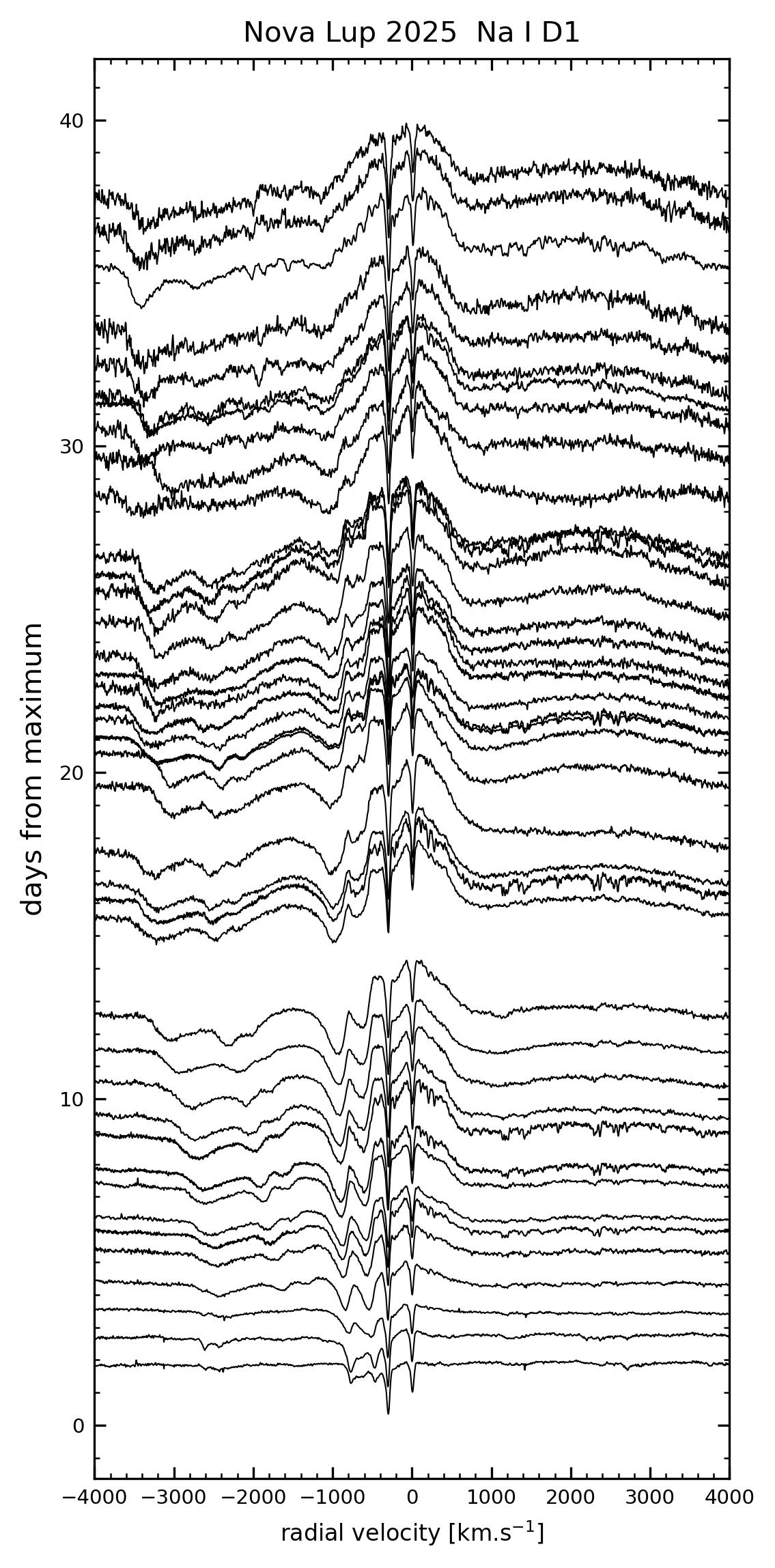

H alpha from spectra secured by 2SPOT, Paul Luckas, Colin Elridge, Alain Maetz & Christian Kreider
[O I] (flux x 3 for clarity)
Na ID
AAVSO Lightcurve (BVRI)
Very classical nova, now around 2 mag under max. Next step: He I emissions
