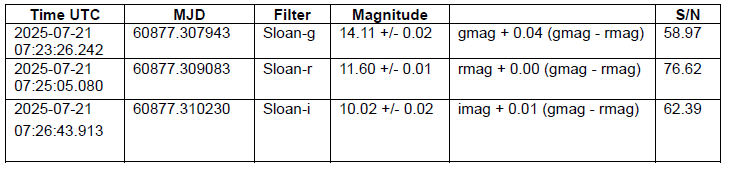

The photometric results:

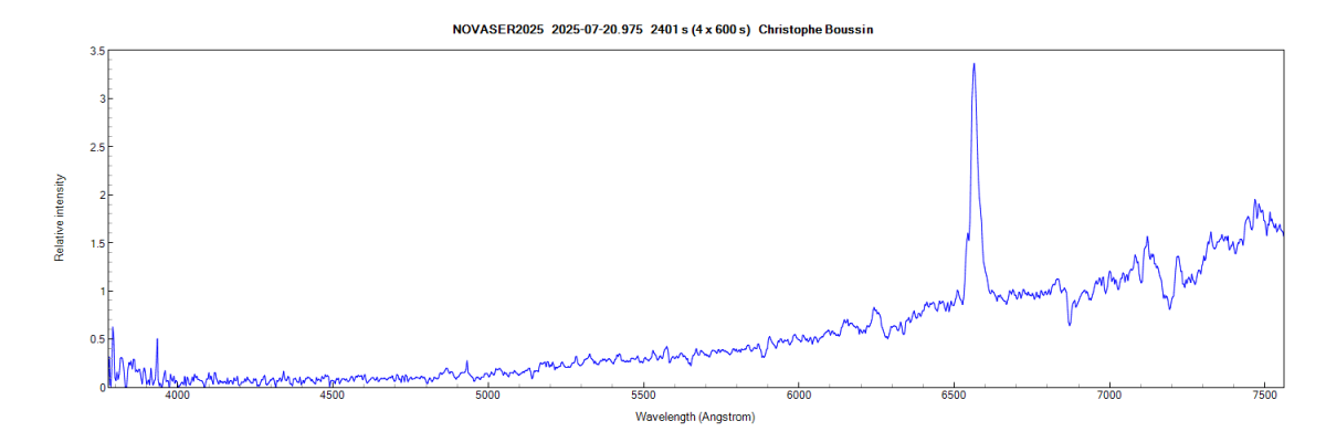

Here is my contribution to the monitoring of Nova Ser 2025.
I obtained the following spectrum the 20th of July at 23 h 24 UT with my Alpy 600 (resolution of 516, JJ = 2460877.4753) and an acquisition time of 40 min (4 x 600 s) :
Nova Ser 2025 on July 20th, 2025 (3776-7560 A)

Nice spectrum, Christophe.

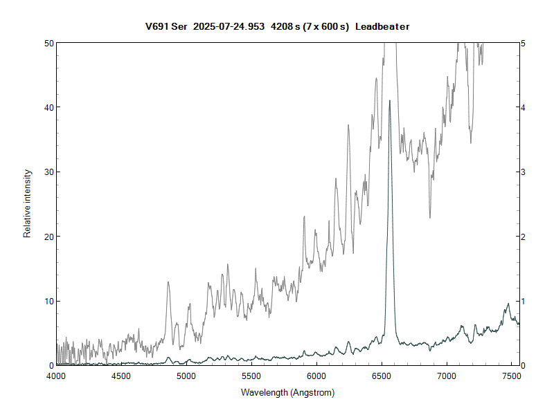

Posted: Fri Jul 25, 2025 9:53 pm
An ALPY 600 spectrum from last night

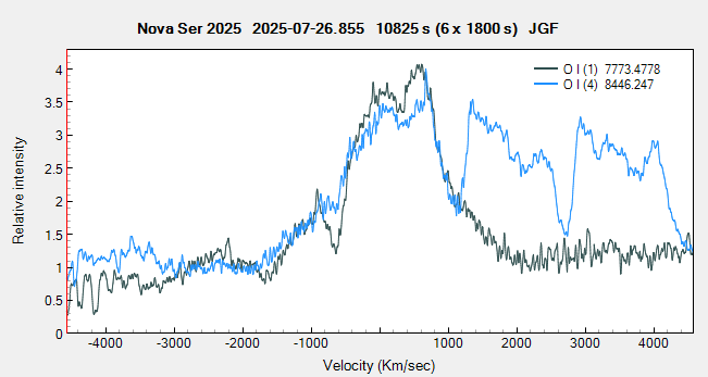

After a lot of cloudy days I could observe Nova Ser 2025 yesterday night. It was on the boundary of SMM remote equipment,
but I have been able to reach this graphics by a NOU_T echelle.
Cheers, J. Guarro.

That's very great, Joan.
Congratulations for the NOUT and the spectrum.
