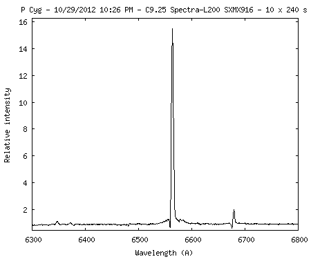

this is my spectra made with L200 spectroscope.
and the profile (ISIS):
This is a wonderful object.

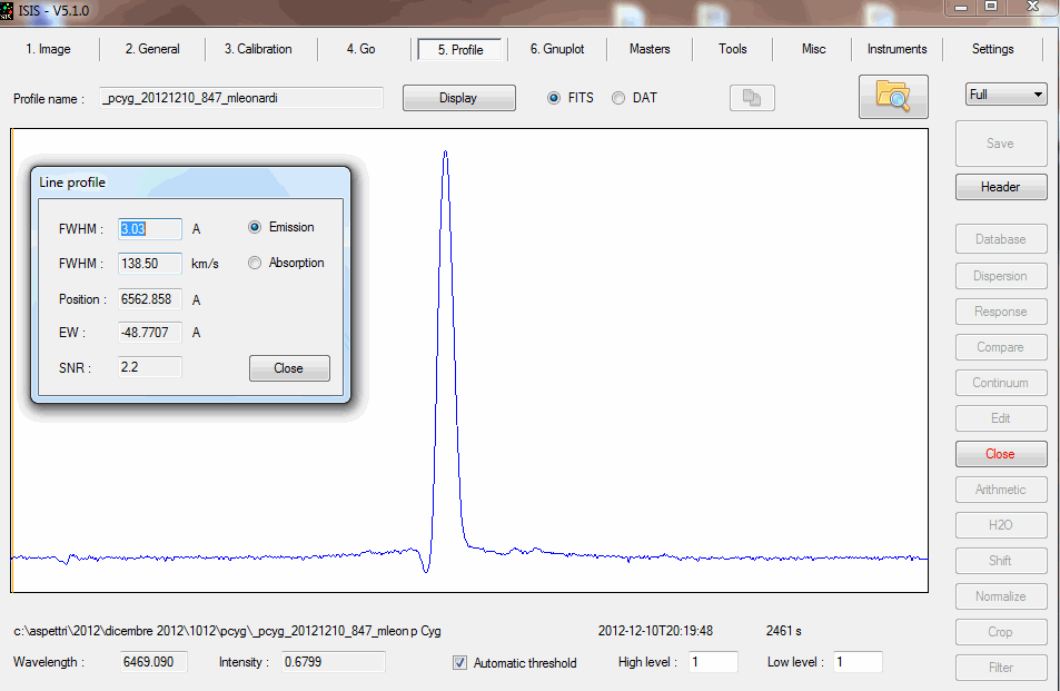

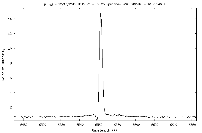

yes it will be a big pleasure for me to partecipate at p Cyg campaign. Recently I installed a new grating: 1800 lines/mm (the previous spectra has been made at 600 lines/mm).
Here below please find yesterday night p Cyg spectra with 1800 lines/mmm grating and the EW at H alpha calculated by ISIS.

So finally I measured the EW using SpcAudace.
I calculated it in the range between 6510 6617 A as per Markova doc.
For my p Cyg spectra profile name is:
_pcyg_20121210_847_mleonardi
SpcAudace command is:
spc_autoew _pcyg_20121210_847_mleonardi 6510 6617
The result is the following:
# Date: 2012-12-10T20:19:48
# JD: 2456272.347
# EW(107.0=6510.0-6617.0)=-88.71 A.
# Sigma(EW)=10.57 A.
# SNR=23.
The value of EW of - 88.71 A seems in the same magnitude of Francois Teyssier data.
I hope the method I used is the correct one for this campaign.
I wonder if all observators are using the same software (SpcAudace) or others.
Thanks and Regards,
Marco

I have normalized the file using SpcAudace and then I made the EW with the following softwares and using always the same lambda range 6510 6617.
Results:
ISIS: -90.73 A using the FWHM command
VSpec: -95.00 A using console and leq 6510 6617 command
SpcAudace: -89.78 A using command spc_ew _pcyg_20121210_847_mleonardi_norm 6510 6617
SpcAudace: -89.78 A using command spc_ew _pcyg_20121210_847_mleonardi_norm 6510 6617 6
SpcAudace: -97.27 A using command spc_ew _pcyg_20121210_847_mleonardi_norm 6510 6617 15
In SpcAudace please note the 6 or 15 digit. This number is related with the continuum extraction method.
Just to share.
Regards,
Marco
Re: P Cyg
Posted: Sun Dec 16, 2012 3:12 am
Into ISIS the spectrum continuum need to be normalized to unity before EW calculation.
I prefer separate the two operations (continuum normalization and EW (latest by using FWHM function)) because normalization quality is very critical.
I use first the "Continuum" function for a high quality continuum fit, then only, I compute EW. Of course, during the fit, you have to exclude
the Halpha line (the extension limit of the line is some empirical here... the important point is the use of same spctral range for a reproductible result on the time).
