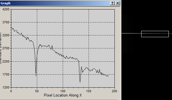

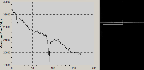

Clear but bright skies here. Doubling in Na D lines is visible even at R~5000 (LHIRES III 1200l/mm)
Re: RR Lyr
Posted: Sun May 26, 2013 12:29 am

Posted: Sun May 26, 2013 12:43 am
Hi Christian,
These are just example raw profiles at 21:57 and 23:29 UT. I have continuous 5 min exposures from 21:47
Is there a recommended reference star for this campaign?
