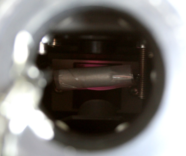

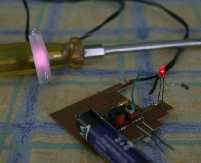

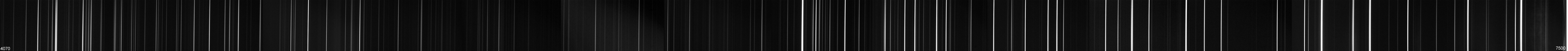

I temporarily placed a RELCO (powered by a disposable camera flash circuit and with a diffuser and a reflector wrapped around it) where the existing neon is in the LHIRES. The results were very encouraging. The attached spectrum is a 10 sec exposure. If the RELCO can be fitted in the same place as the neon, it would make a good replacement calibration source.
- RELCO powered by disposable camera flash
- dispcam_relco_diffused.jpg (108.96 KiB) Viewed 13351 times
- RELCO temporarily mounted in LHIRES
- relco_LHIRES.jpg (69.69 KiB) Viewed 13351 times
