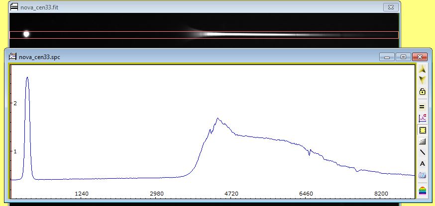

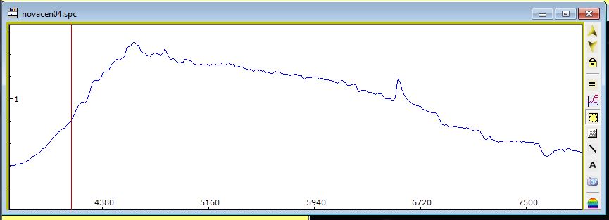

by Ken Harrison
We've been lucky enough to have a couple of clear morning to image the nova.
Yesterday it was showing P Cygni profiles - clearly visible in the Ha, today they seem to have diminished dramatically.
Only lo-res spectra from the Baader 207 l/mm grating on the 4" f5 Genesis - 12A/ pixel, 30s exposures.
Nova Cen 071213
Nova Cen 071213

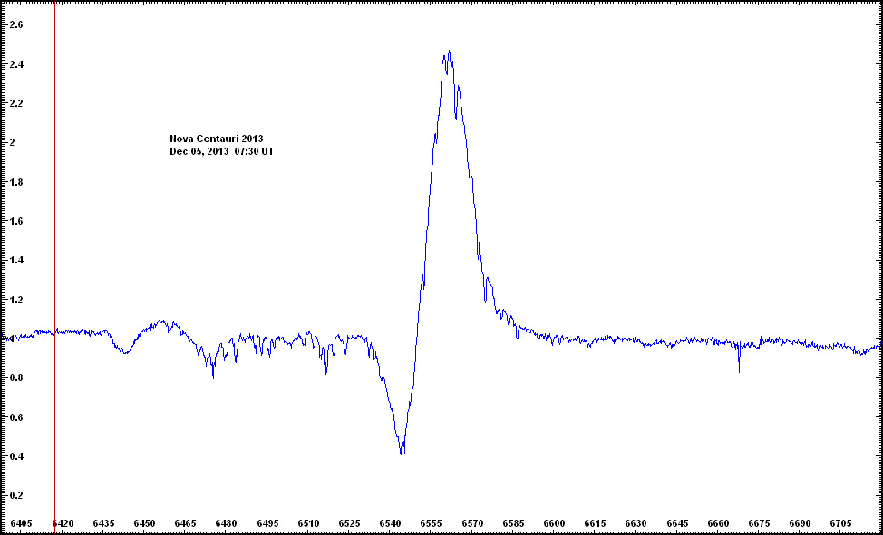

by Tasso Napoleao
Dear friends,
Spectrum of V 1369 Cen taken on December 5, 2013 (07:30 UT) by Rogerio Marcon and Tasso Napoleao. Exposure 600s. Observing site: Campinas, SP, Brazil (22.792271 S, 47.070032 W, height 597m). Spectroscope R=11 000 (grating 2400 l/mm), Newtonian scope 315mm, Audine camera (KAF 1602); all equipment built by R. Marcon. Pre-treatment and reduction made with Maxim DL and VSpec 4.1.2.
P-Cygni profile in the H-Alpha line very prominent in this date. Expansion speed estimated as close to 900 km/s.
Regards,
Tasso.

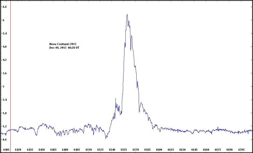

Posted: Thu Dec 12, 2013 6:25 pm
by Tasso Napoleao
Dear friends,
Spectrum of V 1369 Cen taken on December 9, 2013 (06:28 UT) by Rogerio Marcon and Tasso Napoleao. Exposure 600s. Observing site: Campinas, SP, Brazil (22.792271 S, 47.070032 W, height 597m). Spectroscope R=11 000 (grating 2400 l/mm), Newtonian scope 315mm, Audine camera (KAF 1602), all equipment built by R. Marcon. Pre-treatment and reduction made with Maxim DL and VSpec 4.1.2.
The emission in H-Alpha has increased significantly as compared to our December 5 spectrum. On the other hand, the P-Cygni profile in absorption has weakened. This scenario appears to be very similar to the one observed in Nova Del 2013 a few days after the explosion.
Regards,
Tasso.

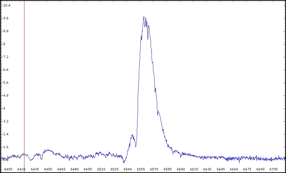

by Tasso Napoleao
Spectrum of V1369 Cen taken on December 12, 2013 (07:12 UT) by Rogerio Marcon and Tasso Napoleao. Exposure 600s. Observing site: Campinas, SP, Brazil (22.792271 S, 47.070032 W, height 597m). Spectroscope R=11 000 (grating 2400 l/mm), Newtonian scope 315mm, Audine camera (KAF 1602), all equipment built by R. Marcon. Pre-treatment and reduction made with Maxim DL and VSpec 4.1.2.
The emission in H-Alpha has further strengthened as compared to the December 5 and 09 spectra. From our measures, we have estimated a development in the EW of the line from about -17 by Dec 05 to -135 by Dec 12, with room for further growth over the next few days. Will keep an eye on it.
Tasso.
