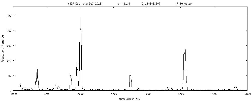

Posted: Thu Mar 06, 2014 6:33 am
My first spectrum for this new saison
Only 4 exposures of 300 seconds each binning x 2
The AAVSO V Mag is 11.8
Impressive [O III] lines
Note that He II 4686 is now well detached
Spectra on :
http://www.astrosurf.com/aras/Aras_Data ... 2013_2.htm

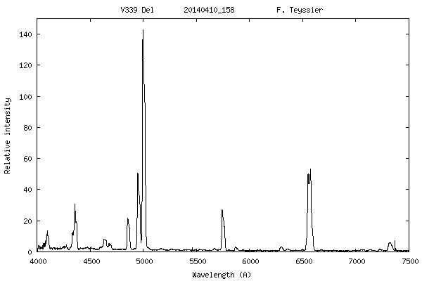

Posted: Sat Apr 12, 2014 10:17 am

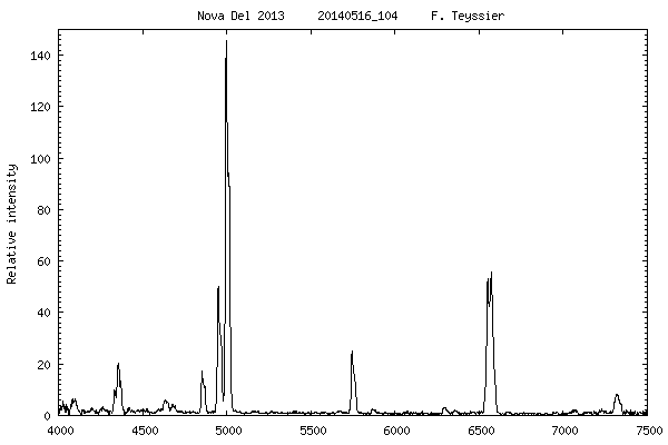

Posted: Fri May 16, 2014 5:42 pm
Today's spectrum

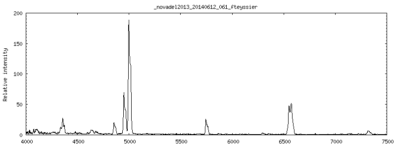

Posted: Sat Jun 14, 2014 10:37 am
13-06-2014 spectrum
