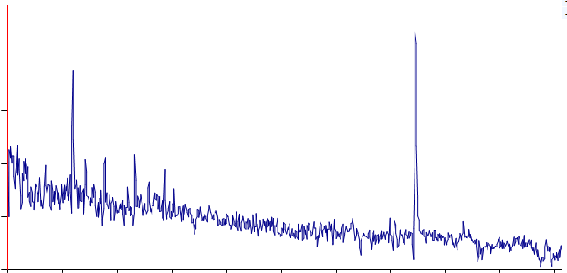

Only one image between clouds
Clearly confirmed as a nova near maximum luminosity showing H alpha with a P cygni profile, and Fe II 42 multiplet^
PNV J20214234+3103296.PNG (21.01 KiB) Viewed 17262 times

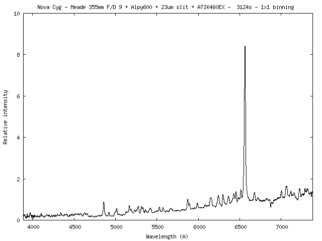

A spectrum taken with C14 at f/d7, LISA spectrograph 35u slit and ATIK 460EX.

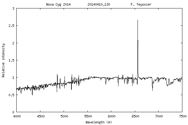

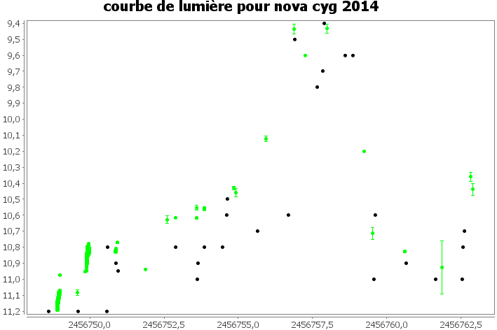

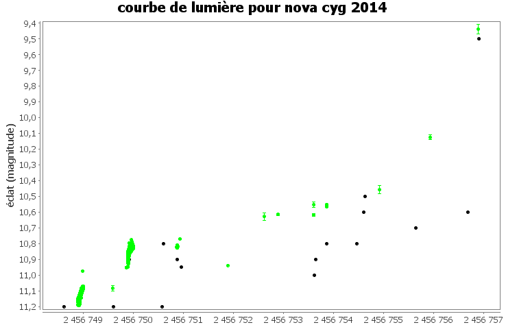

The light curve of the nova is very unusual.
Brightening after maximum or very long pre-maximum halt
Last spectrum from Christian
A daily coverage shoumd be of great interest
The nova is now at mag V = 9.4, so eShel spectra are possible
The ARAS data base for Nova Del 2014 : http://www.astrosurf.com/aras/Aras_Data ... g-2014.htm

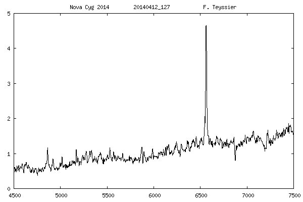

Posted: Sat Apr 12, 2014 7:41 am
Tonight spectrum
Under bad conditions : foggy sky so low SNR
Fast spectral evolution : P cygni profiles disappears and lines widen

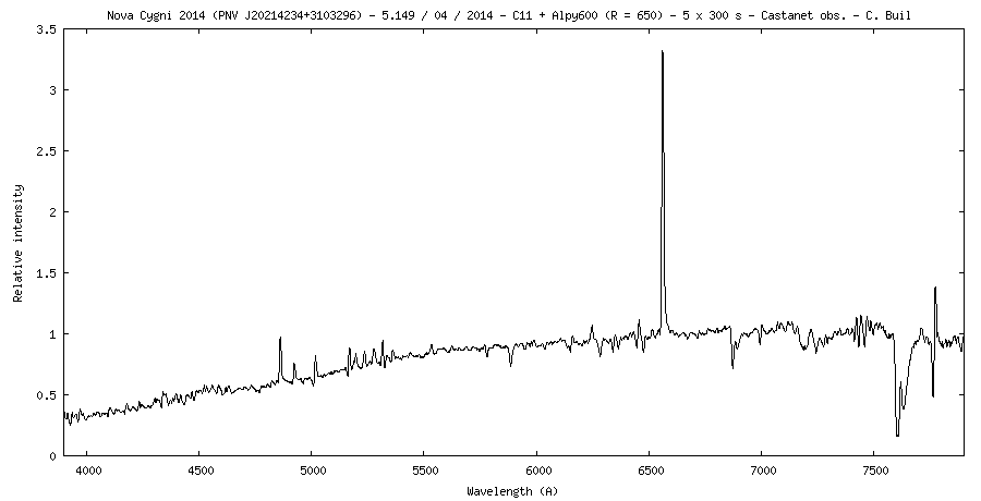

Nova Cyg last night with Alpy 600 R 624
Re: Nova Cyg 2014 = PNV J20214234+3103296
Posted: Tue Apr 15, 2014 8:16 pm
Also a Alpy 600 spectrum taken the April 14.1 with a Celestron 11 (7 x 300 sec):
Short time change (compare with April 9-10 spectra).

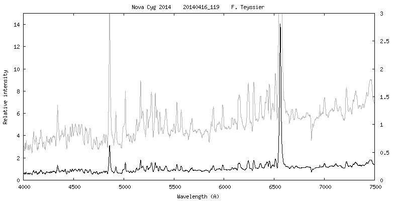

Belles raies dans l'IR, Christian.
La courbe de lumière est particulière avec semble t-il des oscillations.
Spectre de ce matin
