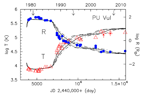

PU Vul is a symbiotic nova, recovering from its ourburt of 1979 (very slow nova)
The spectrum is nebular, very strong emission lines, weak continuum
It's very unlikely that H alpha shows such a variation in very short time-scale.
Selected publications :
Analysis of the nova outburst
http://adsabs.harvard.edu/abs/2012ApJ...750....5K
with interesting result about Diameter (red triangles) and Temperature (blue dots)

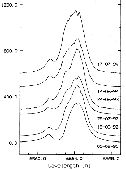

Ha profile at different dates (always strong)
Amitiés,
