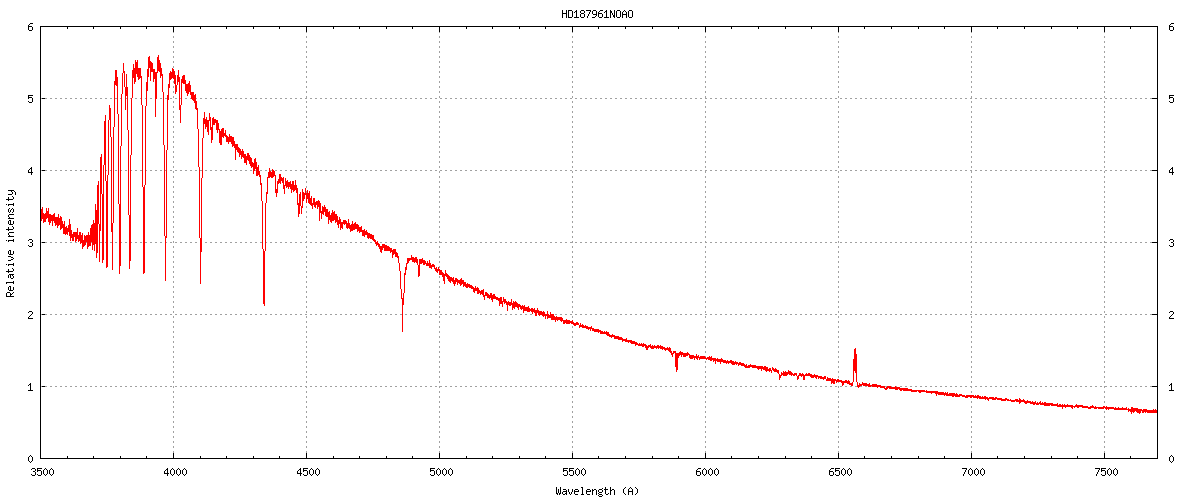

Re: Question about Be star V1466 Aql
Posted: Mon Aug 25, 2014 9:53 pm
by Martin Dubs
I looked up V1466 Aql on CdC and noticed that it is also a reference star in the NOAO catalog
http://www.noao.edu/cflib/
I downloaded the spectrum and converted it into a ISIS readable dat file for comparison with your spectra.
Here is the spectrum:

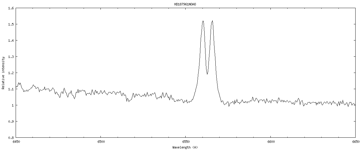

and a zoom-in to H-alpha:
quite similar to Paolo's and Massimiliano's spectrum :)
Apparently this has been a Be star for quite some time.
Martin

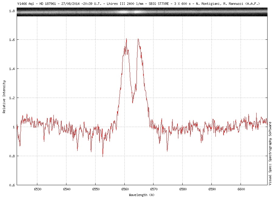

Posted: Thu Aug 28, 2014 3:17 pm
by Nico Montigiani
Hi to all,
here you can see another spectrum of the star V1466 Aql
The spectrum was taken last night.
V1466 Aql - 27-08-14 - AAF.PNG (160.18 KiB) Viewed 10016 times
Clear Skies
Nico
