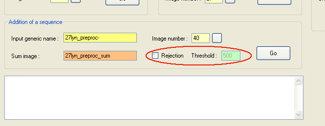

Can anyone tell me what the rejection function does when adding a sequence of images ("Tools", "image processing 2")
Thanks
Re: ISIS rejection function when adding images
Posted: Wed Sep 03, 2014 12:05 am
It is the parameter of a sigma-clipping algorithm for reject deviant values during addition process (for very noisy data, in normal work, do not slect the option). Adjust by successive trial.
