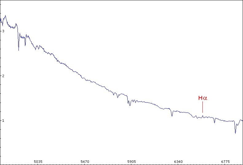

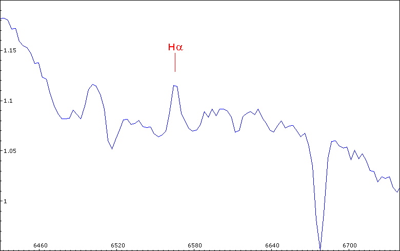

Guys,
this night during our usual observing session we have recorded 3 spectra of the star HD194153 using the 150 l/mm grating.
In SIMBAD this star is classified as B1Iab.
As you can see in our spectrum here attached there is a faint but well visible H alfa emission.
The star is not included in Bess database and we didn't find any literature on internet talking about this star with H alpha emission.
We would like to have your help in order to clarify if this emission in reality is well known or something new.

Massimiliano,
Nico,
Be stars are B non supergiant stars that display or have displayed emission line in their spectrum. If this star is a B1Iab, this means it is a supergiant.
Those supergiant stars may show emission line but they differ from Be stars. Very good exemples are Deneb, Rigel... Another exemples are Luminous Blue Variables such as P Cygni, eta Carinae...
Emission comes from material expulsed by outflow Wind from those massive & luminous stars.
I hope this helps...
