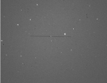

Progenitor should be visible in this animation I made with an old POSS2/UKSTU Red and an unfiltered image (21:58 TU 30 Oct) taken some minutes ago by Massimo Caimmi (thank you Massimo!). His astrometry: AR 03 09 29.77 DEC +26 38 04.6
Lhires III slit view:
I send you FITS profile.
Ciao,
PS: I miss a classical nova... :roll:

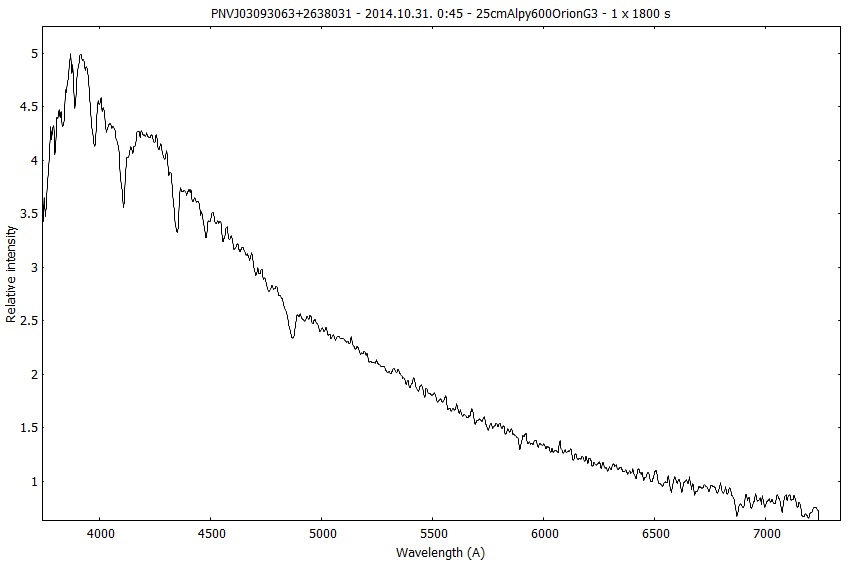

Re: Possibile nova in Aries mag 11
Posted: Fri Oct 31, 2014 11:02 am
by Peter Somogyi
Fog allowed me this yesterday evening (+1 mag to stars...), red part is just noise and that's why Ha is not visible (have not cut at 6000A only for continuum). Anyway it's very blue.
Wanted to shoot more, but clouds dived in unexpectedly.
PNV J03093063+2638031
Slit view is distorted toward edges due to f/4 (fov can be roughly 20").

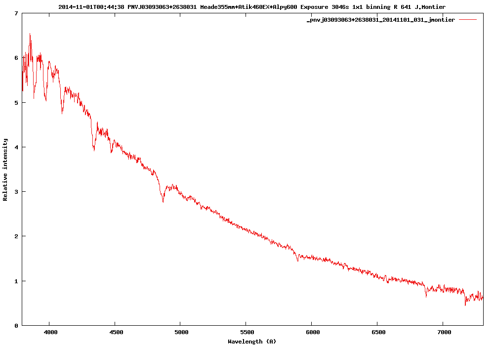

Posted: Sat Nov 01, 2014 10:03 am
by Jacques Montier
Here is my contribution on PNV J03093063+2638031
Regards,
Posted: Wed Jul 01, 2015 9:20 am
by Jacques Montier
Paolo, unfortunately, i don't see any evidence of nebula on my spectrum :(
Halpha is rather weak and does not clearly appear on the spectrum.
Peter ?
Regards,
