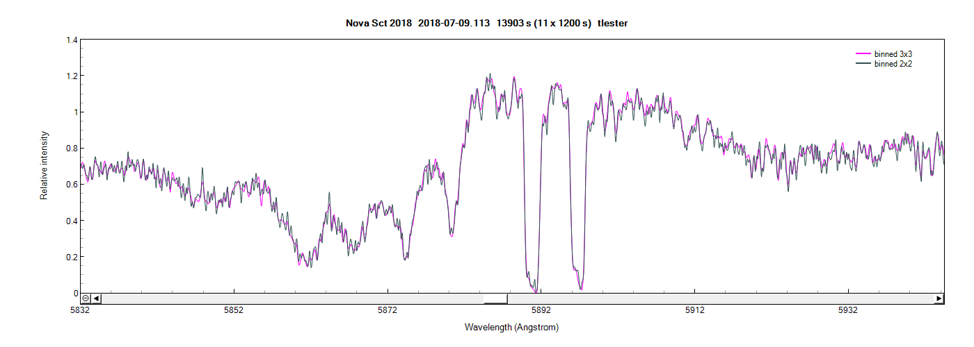

Here is my echelle result for July 9th.
I have replaced my QSI583 imager with an ASI1600mm pro. I am getting much better S/N, particularly at the blue end. Very pleased. :D

Did you bin 2,
Tim Lester
Posts: 168
Location: Arnprior Ontario
Re: TCP J18292290-1430460, mag 10 in Sct
Post by Tim Lester »
To answer your question Francois I actually binned 3x3 (after calibrating and combining the images un-binned).
This gives a sampling factor of only 2.1 which is not really enough. Also I had to leave optimum binning turned off in ISIS.
Here is the same data processed with 2x2 binnnig and with optimum binning turned on. Sampling is 3.2.
And here is a detailed comparison.
I'm not sure if the gain in S/N for 3x3 binning is justified for very faint objects due to the marginal sampling.

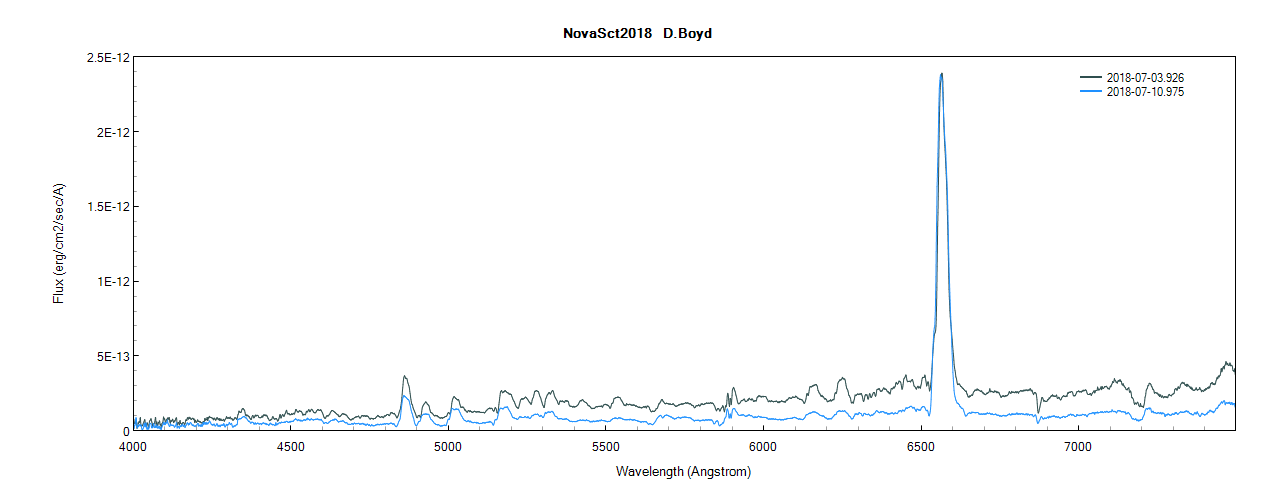

Change in the spectrum of the nova between 3rd and 10th July. V mag has dropped from 10.76 to 11.62 and the (B-V) colour changed from 1.22 to 1.08.
Flux in the H-alpha emission line has increased by almost 30%.
