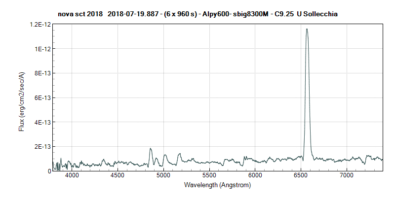

Bonjour à tous, posizionati sul profilo della nuova osservazione du 19 -07-2018 calibré en flux absolu avec la photométrie contemporaine de Paolo Berardi.
novasct2018_20180719_887_Flux_Umberto Sollecchia.png (21.89 KiB) Viewed 23587 times
Last edited by umberto sollecchia on Sat Jul 21, 2018 6:46 am, edited 1 time in total.

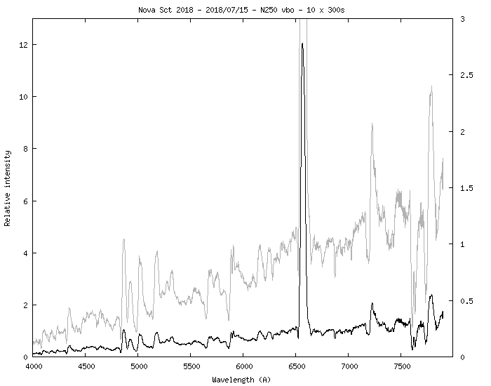

Hello
My little contribution of the Nova Sct monitoring : 10x300s with an Alpy600 spectrograph on Newtonian 250 mm F/4 telescope. I think that the instrumental response and so the continuum is not really good.
The reference star was HD169033 (B5V) to get a nearly similar airmass at the middle of the Nova exposure time. The nova was taken only between 28 and 23 degrees above the horizon ; I've not chosen Gam Sct (A1IV/V) for this reason. I don't know if I've made the right choice.
Vincent
