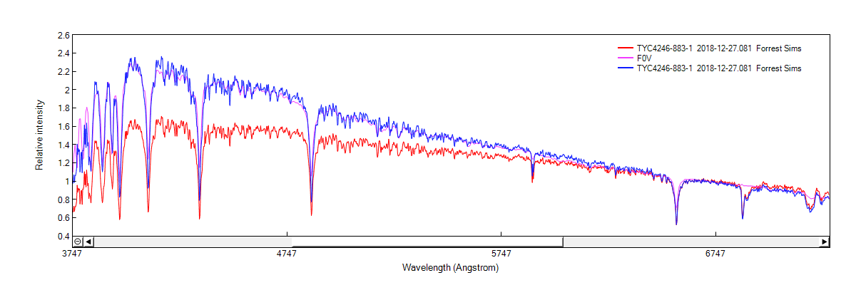

Woody Sims and Hubert Boussier obtained spectra of the target
The spectral type should be ~F0 with insterstellar redenning ~ 0.2
No more spectra are needed (the spectral variability is expected to be very low)
tyc4246-883-1_20181227_081_Forrest Sims_dered.png (70.19 KiB) Viewed 8283 times
Red: raw spectrum
Blue: dereddened spectrum
Magenta: Pickles F0V
Thanks to Woody and Hubert

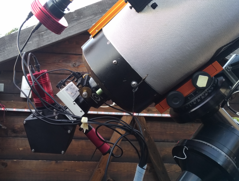

Ma contribution avec UVEX3 N2 en phase de réglage .
UVEX3 N2 sur C8  Aspremont (06)
UVEX3 N2 Obs.png (759.79 KiB) Viewed 8224 times

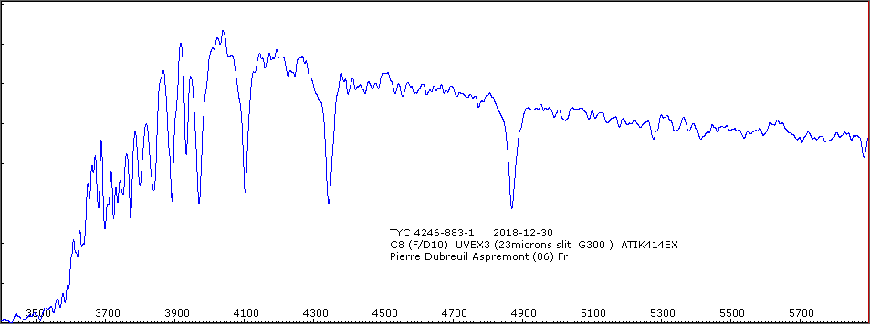

Infos sur l'image
TYC 4246-883-1_20181230_pierre dubreuil.png (13.22 KiB) Viewed 8224 times
Il y a encore du boulot !
