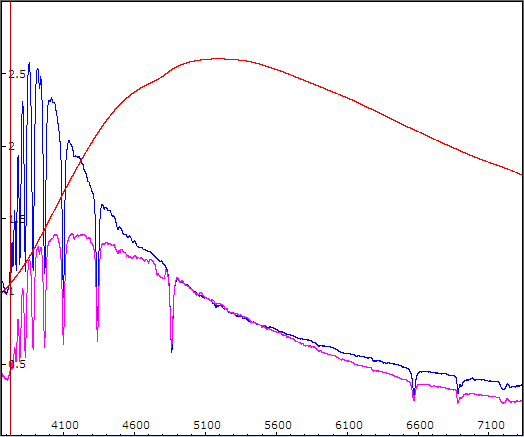

Re: Focuser and reducer for Lisa and Meade
Here is an extreme example from 2 nights ago of the effect of focus drift when using an achromatic focal reducer. My CII is an aluminium tube model and shows large drifts in focus with temperature. I started an observing run by measuring a reference star. The temperature of the telescope dropped significantly during the run so by the time I remeasured the same reference star ~2 hours later, the focus had drifted significantly. This does not matter so much with a fully reflective telescope. The spectrum stays the same. You just lose some light because the star overspills the slit. Because the focal reducer is achromatic though the shape of the spectrum changed completely because the wavelengths in the star image which pass through the slit are different. Note how the ratio between the two spectra (red) is an exact copy of the focus error curve for an achromatic lens

If the spectral response changes with focus position and this one drifts with temperature, i guess a solution would be a focuser that automatically changes position with temperature. A TCF from Optec, for example. I use one in my other telescope for photometry and Works pretty well.
Hi David,
Sorry TCF systems and APO focal reducers are outside my budget so I dont have any experience but would obviously be a good thing. Using a standard achromatic focal reducer and an SCT is certainly not a show stopper though and is a very common setup among LISA/ALPY users here. You just have to be aware of the issues and work round them, for example by taking reference stars at start and end of an observation. If I were choosing a scope for spectroscopy now, I think I would go for a fast telescope with a carbon fibre construction and fully reflective optics matched to the fast low resolution (ALPY) spectrograph and use a Barlow to match to the slower high resolution ( LHIRES) spectrograph where the spectrum range is limited so chromatism is less of a problem.
