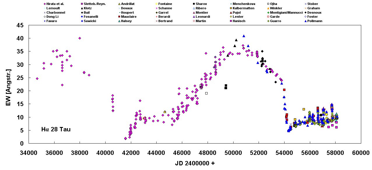

Dear colleagues,
here I want to show once more in detail the 28 Tau periastron observation of several members of the ARAS group.
The evaluation of V/R and RV allows very precisely the time determination of the periastron passage. This result shows impressively the advantage of campaign observations within a community.
It shows also very clear the process of disk deformation at the V/R change during the minimum of the radial velocity, a phenomenon that could be observed for a first time since August 2011 (approx. JD 2455800), when the mass of the disk reached the minimum.
This disk minimum is reflected in our monitoring of the Halpha EW (see the following monitoring).
