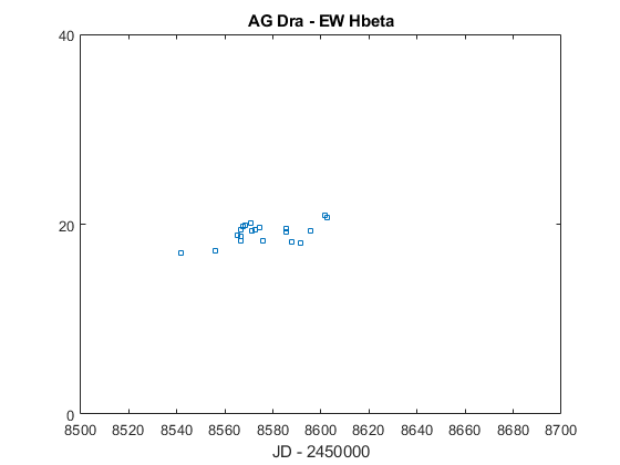

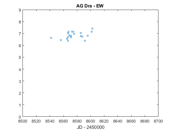

- Posts: 1567

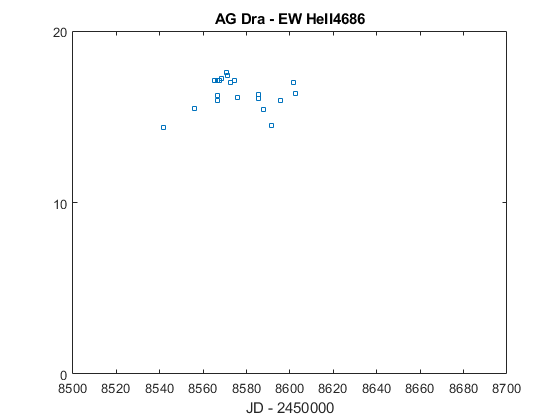

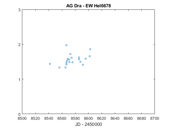

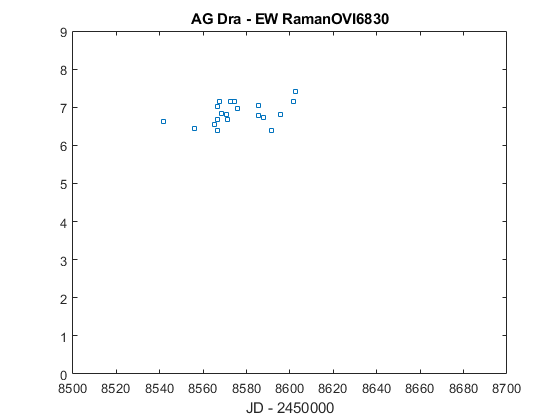

An update.
AG Dra is still in quiescent state (photometry and spectroscopy)
Last results from spectra (Echelle) gathered in ARAS base:
Interesting: the light curve is steady at Mag V ~ 9.7. The EW of the main lines is increasing slowly.
Good coverage, Excellent results, thanks to all.
We are undergoing the observations at a low cadency (low and higher resolution).
Even if, this year, the target doesn't produce an outburst event, the data will be very important to produce a baseline (Joroslav's communication).

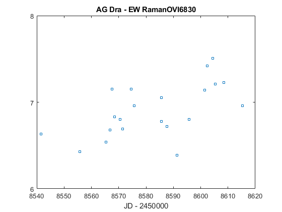

- Posts: 1567
Joroslav's comments:
The behavior of AG Dra is quite interesting. The brightness doesn't seem to change significantly. Absorption in the blue wing of H alpha is still quite prominent. However, EWs are slowly increasing (not only for low excitation lines, for which the changes with the orbital period are expected). As I said previously, we will see how the evolution will continue. Everything is possible, this is a very unusual activity stage.

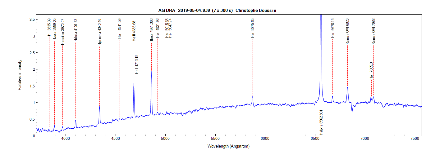

- Posts: 172

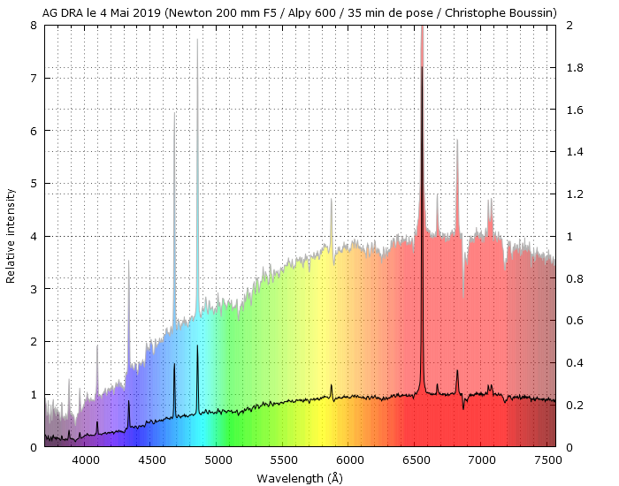

Here is my last contribution to the AG Dra monitoring.
I obtained the following spectrum the 4th of May at 22 h 31 TU with my Alpy 600 (resolution of 506, JJ = 2458608.4388) and an acquisition time of 35 min :
Clear skies,
Clear skies,

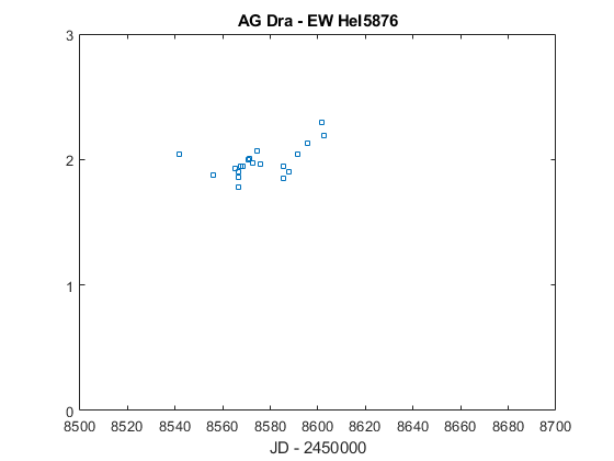

- Posts: 1567

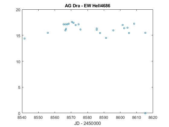

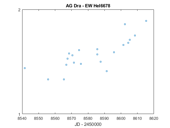

Still quiescent
Only the singlet He I 6678 is sllghtly increasing:
Ongoing observations until late May, the outburst remains possible.
