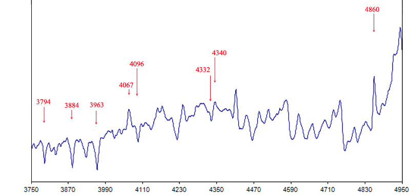

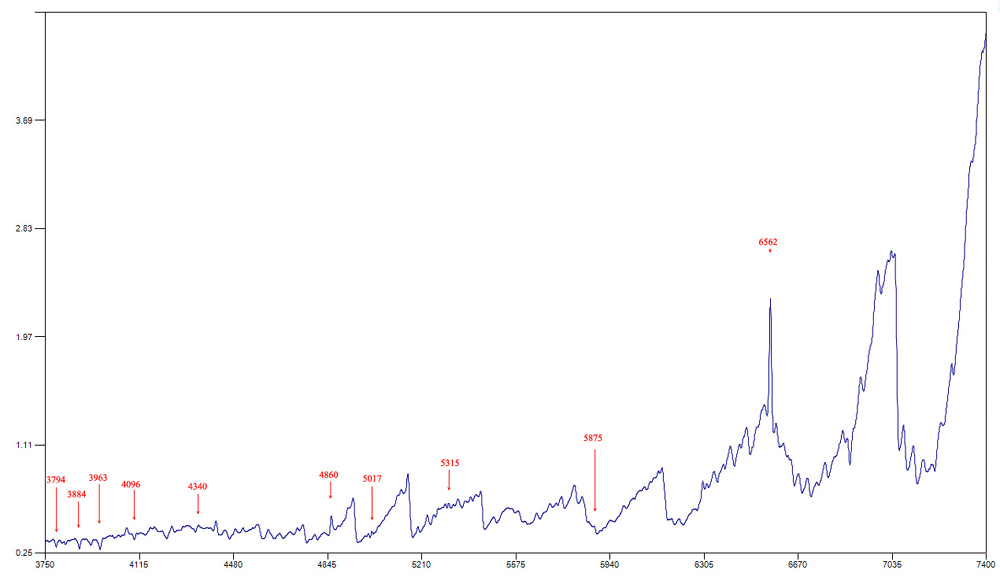

I did gif animation my low res CH Cyg observations 31.7,19.8 and 29.8.2018.
Sorry for the vague quality compared to your pros. However, I decided to share this, because I think that there are all kinds of things happening there, however, no glue what.
Wide range changes possibly resulting different reference stars 31.7 Vega, 19.8 and 29.8 HD181470, and varying humidity conditions and my inexperties. First is "full spectrun 3750-7400Å and second is same "zoomed" 3750-4950Å.
30cm F4 Newton + Alpy600 + Atik314L+

- 1 CH CYG 2018_07_31 N – Kopio_pipp.gif (141.86 KiB) Viewed 39611 times
- 1 CH CYG 2018_07_31 zoom x10 b M_pipp.gif (146.48 KiB) Viewed 39611 times

Hello Timo,
It looks good results at a first glance.
At least some of the variations are real. See for instance H beta according to the continuum
Your spectra are welcome in the database
