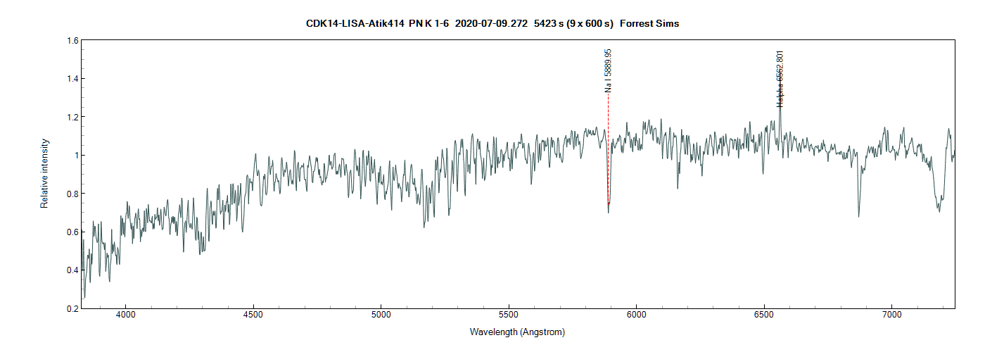

I had a go at PN K 1-6 last night and here is what I got with (9) 600sec exposures. The data has been submitted to François for the database.
Woody Sims

Hi, a sequence of UVEX spectra of the proposed objects :
PN K 1-6 - Clearly not a symbiotic star. Halpha line is in small emission, confirmed on two independent observations on two successive night (the spectrum given is the sum of the two night) :
(instructive to compare to sims's spectrum - for the UVEX configuration used, lower resolution but better SNR).

Woody and Christian, thank you very much for your great work!
I have analyzed your observations, together with available photometric and spectrophotometric data, and here are my (preliminary) results:
V1017 Cyg: G0-2V, this is more or less consistent with the absolute magnitude calculated using the distance of 1100pc from Gaia. Variability with a period of 0.33 days. Although proposed as a symbiotic binary or RR Lyr, this would be rather a W UMa binary (subtype W).
V379 Peg: Although the spectrum has a low signal to noise, it is similar to M2-4V. Luminosity class is confirmed by the photometry assuming the star is located in the distance of 107pc as given by Gaia. Therefore it is rather a dwarf star then a symbiotic binary. Spectrum with a higher signal to noise may reveal some emission lines due to the chromospheric activity of the star.
PN K 1-6: Confirmed not to be a symbiotic star by spectroscopic observations, however, the real nature is still puzzling. Spectrum (and brightness assuming the distance 268pc from Gaia) is consistent with K2V star with some excess in the blue region, consistent with the blackbody with a temperature of few tens of thousands K. Object was confirmed to be a PN, so hot pre-WD or WD is expected, several PNe has binary central stars. However, there is a ~21 days variability in the light curves which would rather point to pulsations of a giant star. Moreover, there is another, fainter star in the vicinity of PN K 1-6 with the very same distance and same proper motions, which would suggest that these stars are physically connected... Although it is not a symbiotic star, this object deserves further attention. The curve of radial velocities would be helpful, but I am afraid that the object is too faint for higher resolution monitoring.

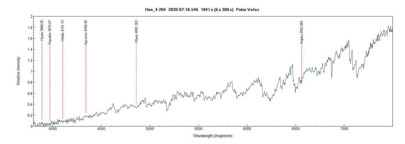

Here are my spectra for southern targets Hen 4-204 and EC 19249-7343.
Please treat these as provisional - I had limited time last night and want to check that I imaged the correct stars.
Balmer emissions are very modest, if present at all, in both stars. Emissions are most pronounced for H gamma.
Francois, I have corrected these for HRV (determined in ISIS when processed) and V reported in Simbad. Do you want the spectra provided with or without these adjustments?
Pete
