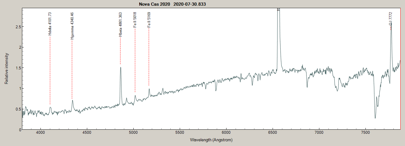

Last night's result with my 300/1200 Newton, 6 x 30 minute, Alpy 600 (18 micron slit), ATIK 414 EXm:
The reddening is obvious.
I am wondering, what can be the emission at 4922A (used to be He I, but it has emission elsewhere).
Moreover, O I 7772 has prominent P-Cyg profile, though it's blended:

Peter Somogyi wrote: I am wondering, what can be the emission at 4922A
Hi Peter,
It appears in my spectrum too. The emission peak is at 4924A so could be Fe II 4923.92
There is also Fe II 5316.23 and visible faintly just in your spectrum I think, Fe II 5264.18
(Fe II Line identifications from Visual Spec)

Hi Robin,
Thank you for the line identification, so those all 4 peaks in your spectra then Fe II emissions then!
Last night I've made a repeat, same instrument and amount of exposure (6x30 minute) - except that got the star higher:
There is a large Balmer EW decrement (similar including H-alpha) and O I 7772 emission, whilst the EW of all the "Fe II curtain" remained similar.

Peter,
I confirm: Fe II (42) multiplet always appears as 3 lines: 4924, 5018 and 5169
It is often the brightest multiplet
