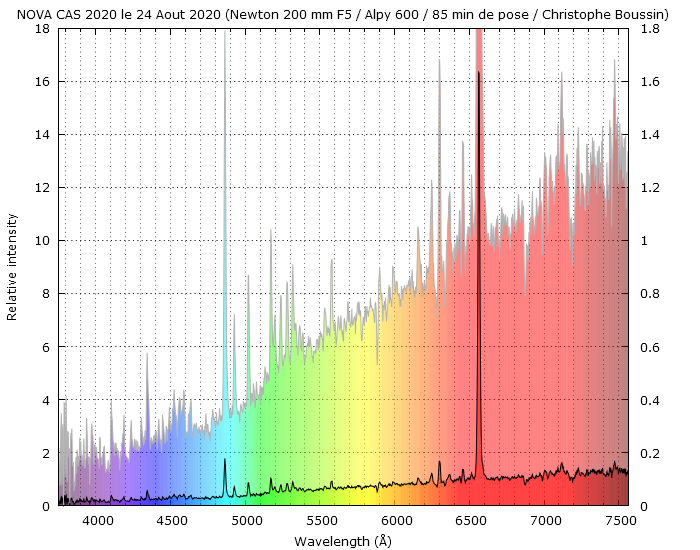

With a less favorable weather than at OHP, I think, I have, I obtained the following spectrum of the nova Cas 2020 the 24th of August at 22 h 51 TU with my Alpy 600 (resolution of 501, JJ = 2459086.4521) and an acquisition time of 85 min :
Nova Cas 2020 on August 24th, 2020
_novacas2020_20200824_952_Christophe Boussin_3750_7565.png (91.71 KiB) Viewed 8574 times

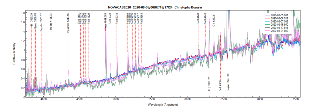

Nova Cas 2020 on August 5th, 6th, 7th, 15th and 17th and 24th, 2020 (identification of lines from PlotSpectra)
Like the Balmer lines, the FeII lines are increasingly visible !

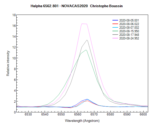

Evolution of the Halpha line :
Halpha line on August 5th, 6th, 7th, 15th, 17th and 24th, 2020
novacas2020_20200824_952_Christophe Boussin_Halpha.png (28.14 KiB) Viewed 8574 times
The relative intensity of the Halpha line is still increasing !
