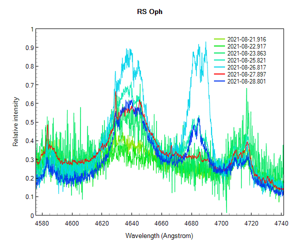

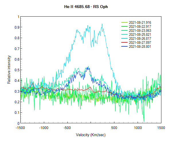

The evolution of He II from echelle spectra secured by Joan Guarro and François Teyssier
Rise, fading (red) and recovery (blue)
rsoph_20210821_916_F Teyssier.png (90.67 KiB) Viewed 21665 times
The same in wl space with also the variations of NII 4640 which follows He II, to a lesser degree
rsoph_20210821_916_F TeyssierWL.png (128.26 KiB) Viewed 21665 times
