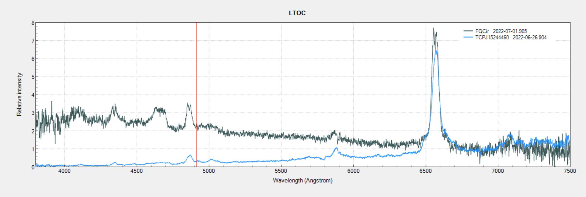

I managed another on FQ Cir - it's about 3+ magnitudes fainter, so noisier even with a 4 hour exposure. There aren't obvious signs of narrow absorption lines from a 'normal' shadowing star over the precursor. The continuum has shifted to the blue a lot, and there is a new very wide feature at around 4600-4700 angstroms. The Balmer lines are showing very clear double peaks (some kind of disk I presume?).
PlotSpectra is showing New Zealand times. Subtract 0.5 for UT.
The instrumental setup, response star and reduction procedure are the same for both spectra - the only difference is in exposure time. I'm really not sure what to make of this. It would be good to have confirmation that I haven't messed up the observation somehow...

Though Hamish has just pointed out that a shadowing B star with big H absorption lines would create double peaks as seen here. And I think it might also explain the shift to the blue in the continuum.

I think that would fit as an explanation of the Balmer line twin peaks and the continuum slope shift (assuming the nova was further away and even more reddened), if the potential progenitor spectrum was actually unrelated and blended with the nova spectrum. Though I'm still a bit unclear on the 4600-4700 Angstrom feature and what it might mean.

Tom Love wrote: Though I'm still a bit unclear on the 4600-4700 Angstrom feature and what it might mean.
He II N II blend ? (There are other broad NII lines in the spectrum I think)

Yes, perhaps something like that, which is consistent with the feature emerging as the continuum drops.
