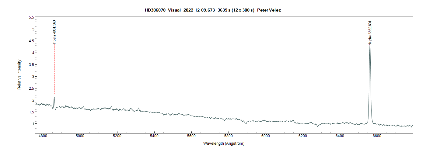

- Posts: 153
A follow up on Hamish's observation of HD306070.
Two spectra from last night - one taken in the UV, the other in the visual spanning H beta to H alpha. Resolution of around 1000 - taken with UVEX using a 600 lines/mm grating through a Planewave CDK 12.5. Happily - all automated while I slept as it was only observable in the early hours of this morning.
As Hamish's spectrum shows, there is a substantial Ha emission and another, though much smaller at H beta. It may simply be noise but to my eye there is a modest emission in some of the higher energy Balmer lines.
Looking more closely, there appear to be quite a few Fe II emissions as well. The 2 spectra overlap so I was able to confirm that these emissions are not just noise. I've attached an annotated plot of the visual spectrum with the y axis stretched to highlight the emissions. I couldn't find any He I emissions - the bump at 5018 is more likely Fe II than He I at 5015.68.
This target is described in Simbad as an emission-line star (which sounds like a fudge to me) and allocated spectra class B2. This is based on a survey undertaken in 2003. While the continuum may look like a B star, there shouldn't be Fe II emissions. I'll leave it to the experts to interpret this further.
I plan to work in the NIR and IR this evening - will report on anything I find.
Pete
