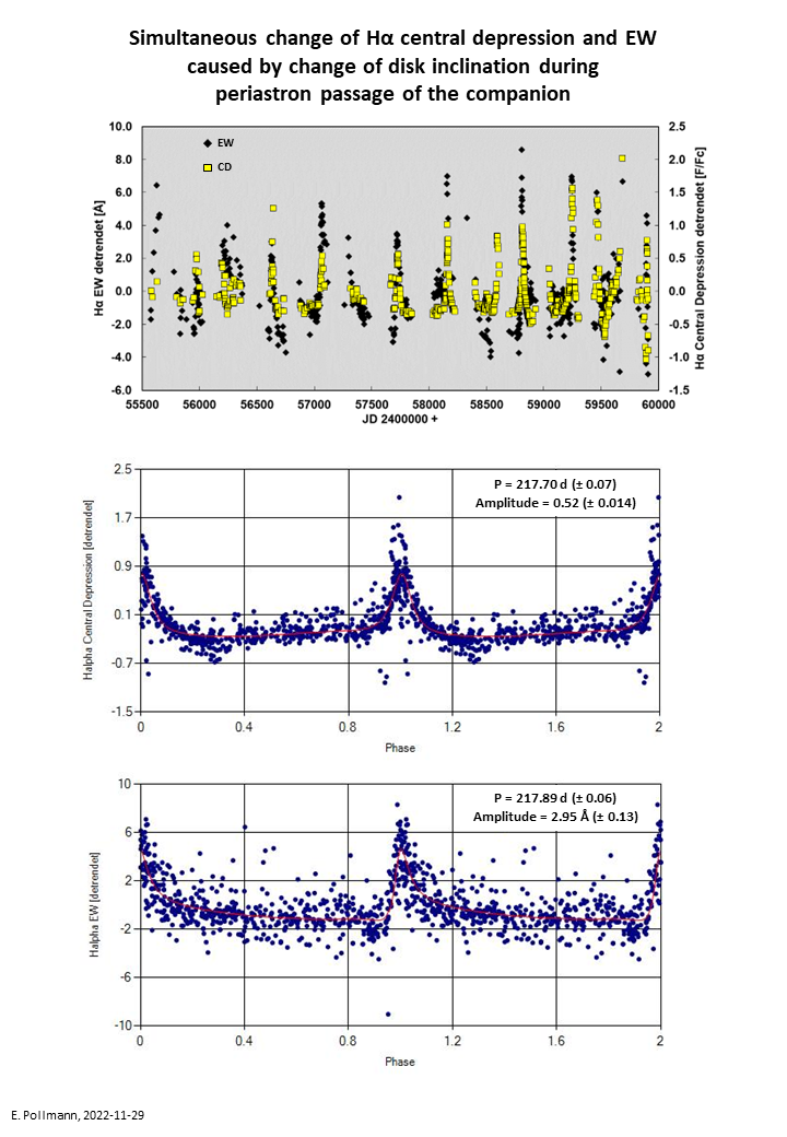

The last periastron passage took place on 2022-11-15 (JD 2459898.7).
The new observation data of A. Leduc, E. Bertrand, B. Hanisch, J. Martin, A. Stiewing, E. Pollmann enables an actualized of the orbital period of the companion (see attachment).
CA und EW Periodenanalyse.png (359.03 KiB) Viewed 20899 times
