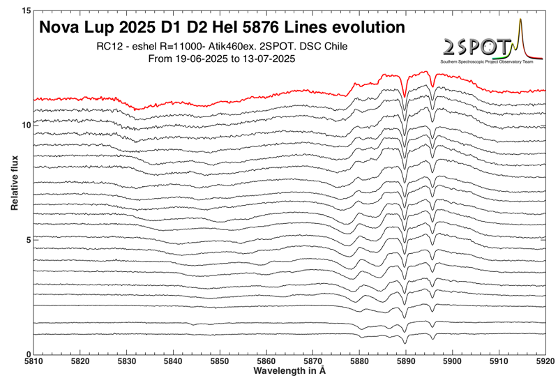

Our 2SPOT team continues to follow this nova from Chile with an eShel spectrograph (R=11000).
Here's the evolution of this nova on the H Alpha line with the 21 spectra we've made to date
the evolution of the Iron lines (between 5120 and 5300 Å)
And the evolution of the D1 D2 lines and the Helium I 5876 line
Its current magnitude still allows us to follow it with the eShel spectrograph

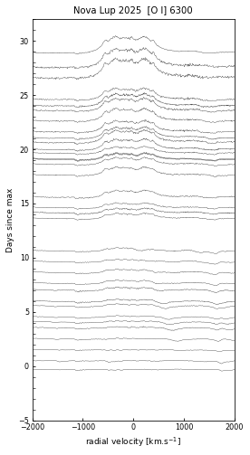

Posts: 1567
Re: Nova Lup 2025
[O I] line in spectra secured by Team 2SPOT, Colin Elridge, Paul Lukas
The spectrum is evolving toward the nebular phase

Posts: 1567
Re: Nova Lup 2025
H alpha from spectra secured by 2SPOT, Paul Luckas, Colin Elridge, Alain Maetz & Christian Kreider
[O I] (flux x 3 for clarity)
Na ID
AAVSO Lightcurve (BVRI)
Very classical nova, now around 2 mag under max. Next step: He I emissions
