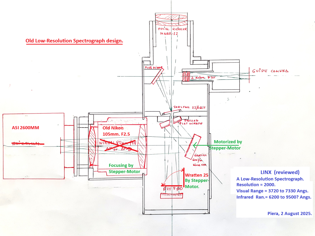

Linx, a Low-Resolution Spectrograph Project
- Posts: 731
I present to you the Linx, a revised low-resolution spectrograph.
The goal is to achieve a complementary tool for the NOU_T scale, since with it
it would be possible to observe objects around the 14th visual magnitude.
I hope that you like it.
I'm going to say in next few weeks how things are doing.
Cheers, J. Guarro
Cheers, J. Guarro

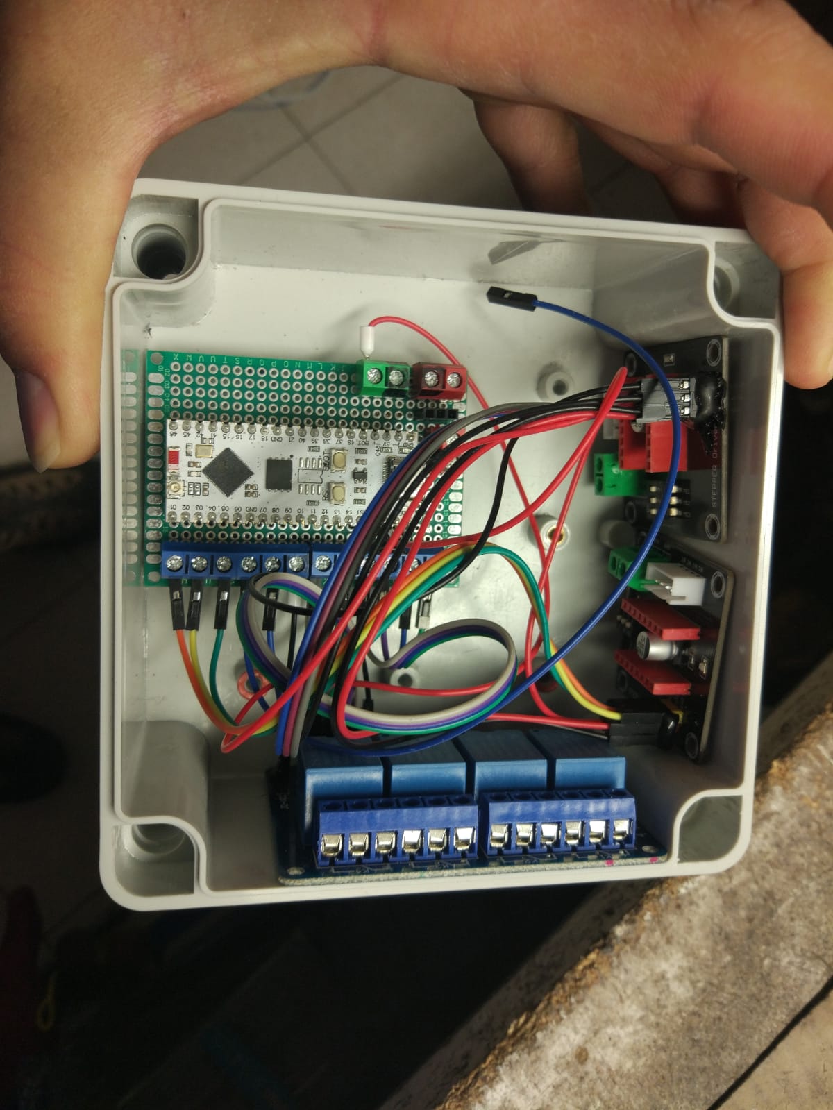

- Posts: 731
Re: Linx, a Low-Resolution Spectrograph Project
Hello at all,
You can see in these pictures the current build state of the two LINX, their mechanical parts are quite finished, meanwhile
Toni is making their electronic cards and software. Remember that the remote observer needs to act over the objective camera
focus, the Wratten 23A filter ON/Off, and over the 600 l/mm grating orientation.
Cheers, J. Guarro.
Cheers, J. Guarro.

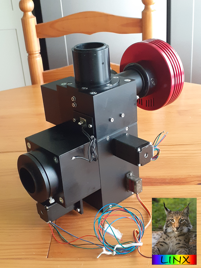

- Posts: 731
This is one of the two LINX mechanics parts finished with an ATIK314L+ camera for guiding. Meanwhile,
the second one is located in the anodizing workshop.
The next step is mounting their electronic card and optical components, and, of course, a camera for taking spectra.
The aim is to finish it before Christmas.
Cheers, J.Guarro.
Cheers, J.Guarro.
- MAKING THE LINX 4.png (961.18 KiB) Viewed 17411 times

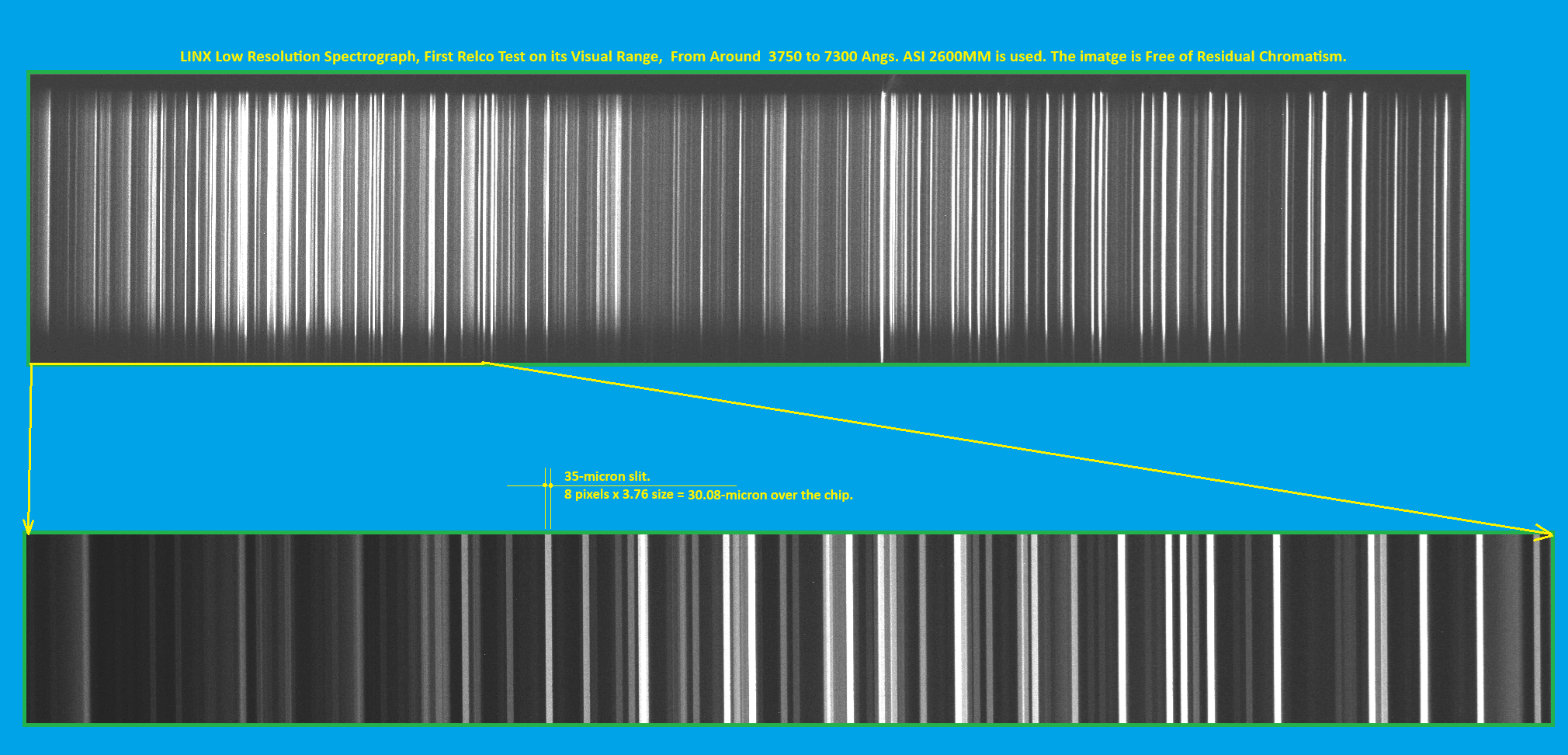

- Posts: 731
Step by step, the LINX low-resolution spectrographis almost finished.
You can see here the LINX with its scientific camera, an ASI2600MM, and its first RELCO light test.
Toni is focusing his attention of finishing LINX's electronics now.
Cheers, Joan.
Cheers, Joan.

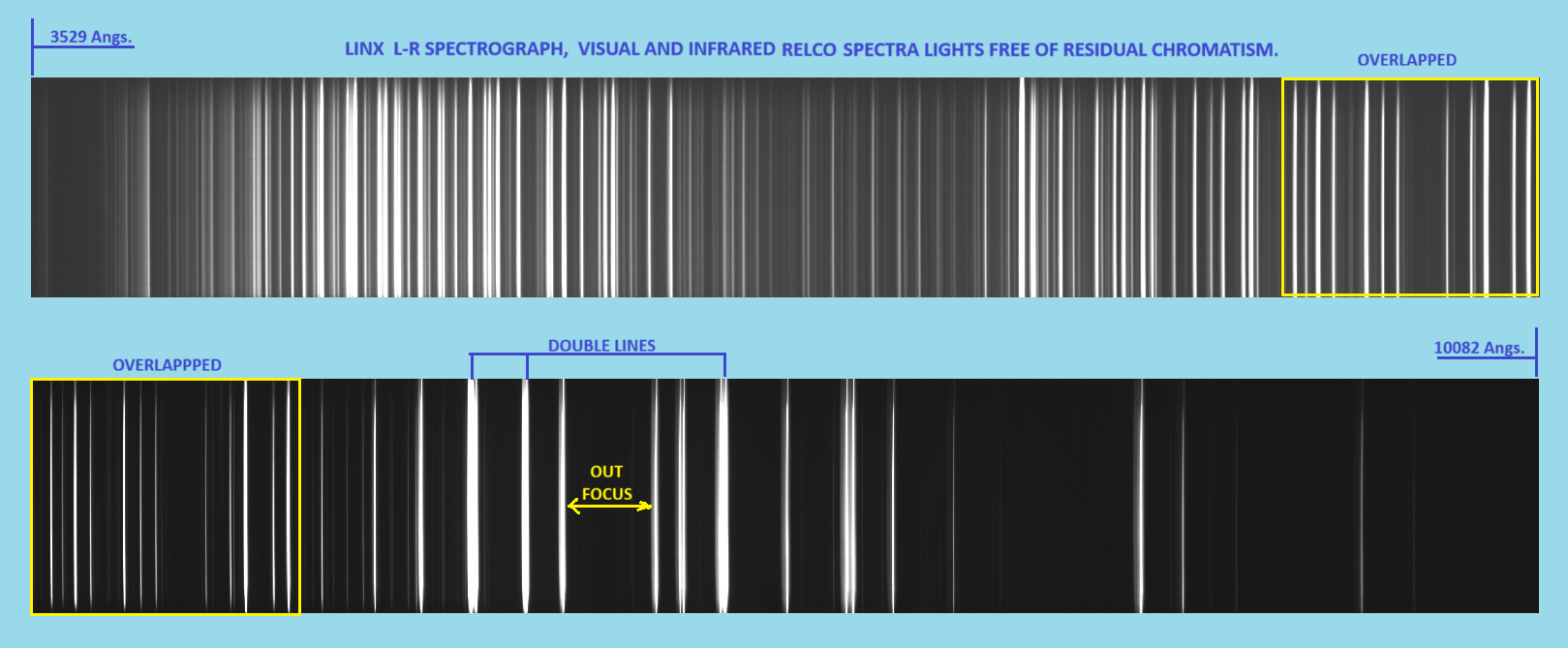

You can see a first, and very tentative, test of the resolution capabilities of the LINX; further testing will be done when the electric focus and the grating position are working.
Sorry, I can't show the infrared results.
J. Guarro.
J. Guarro.
- DIA4 RESULTATS.png (51.97 KiB) Viewed 13807 times

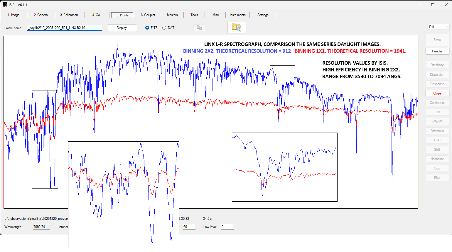

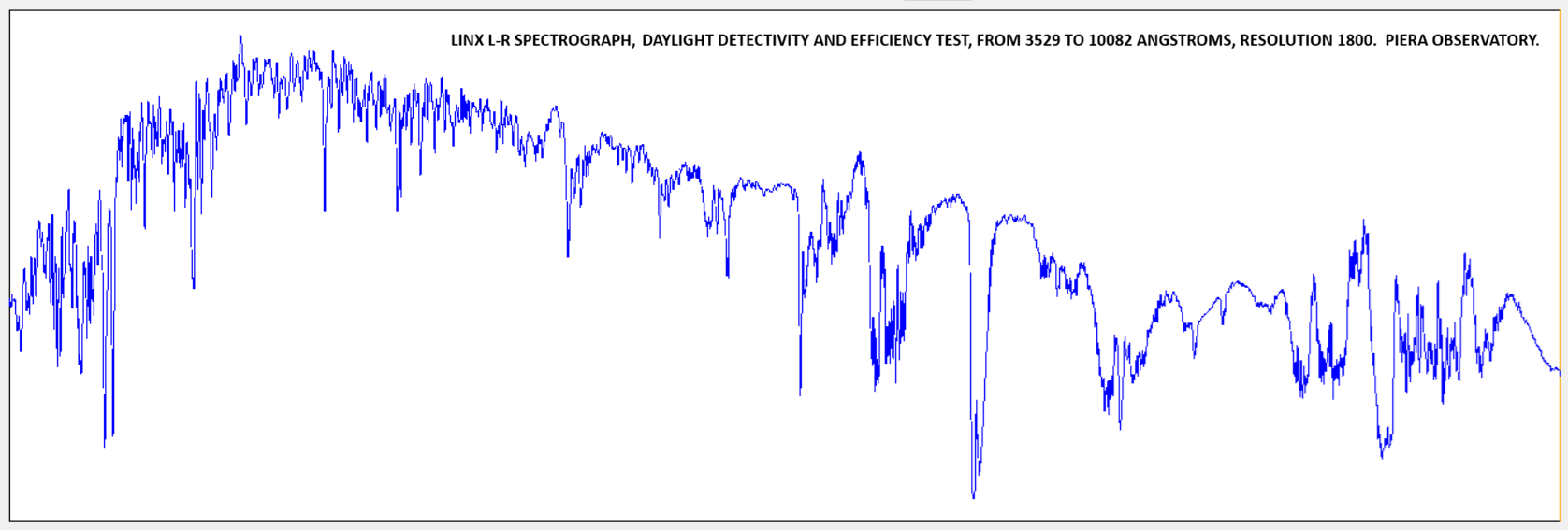

- Posts: 731

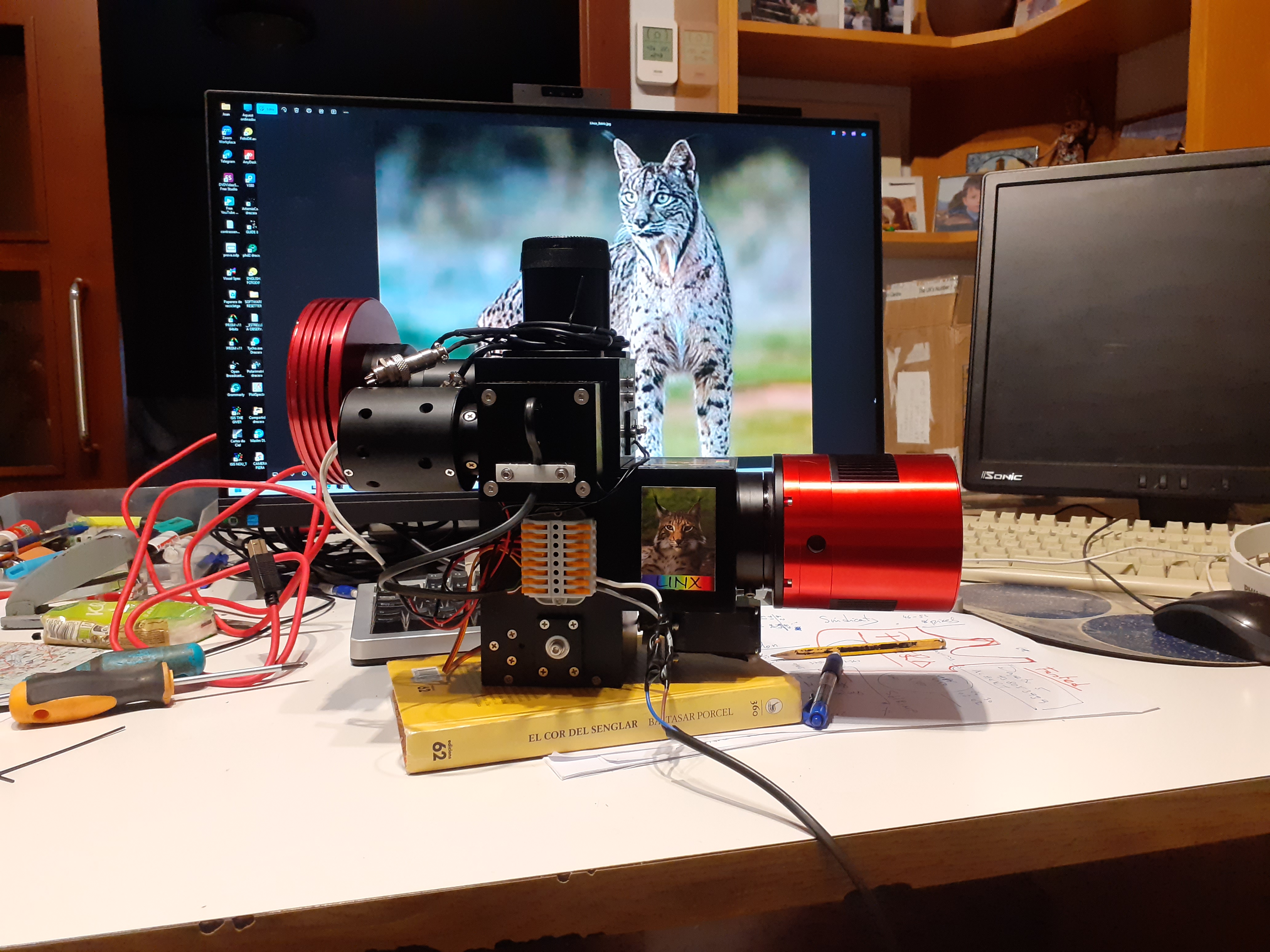

A second Linx's daylight test...
J. Guarro
J. Guarro

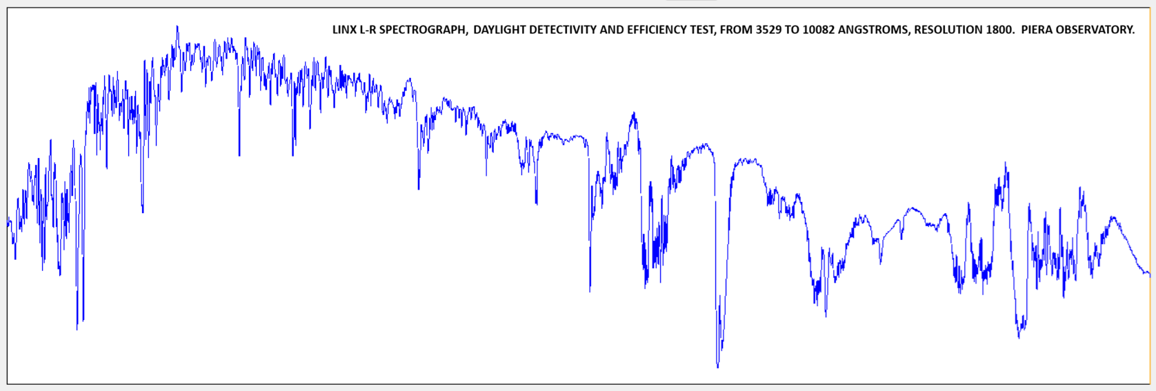

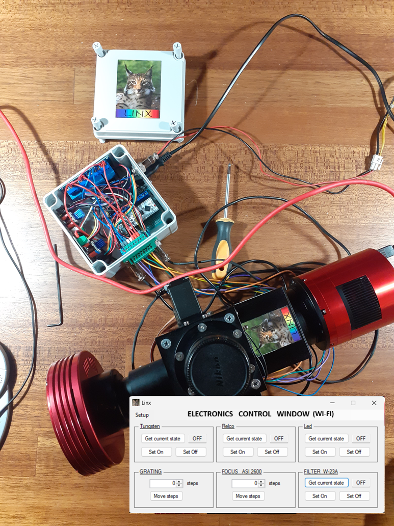

- Posts: 731
Another step...
J. Guarro.
Another step...
J. Guarro.

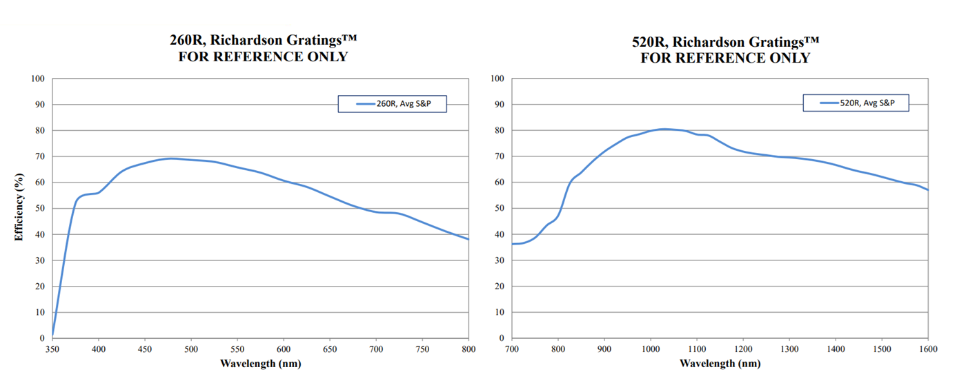

- Posts: 731

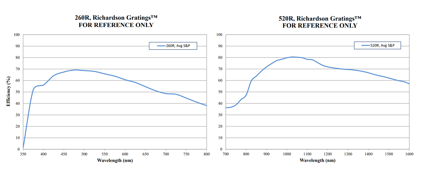

In the sense of giving much better effectiveness in the infrared region of the LINX low-resolution spectrograph, Toni and I are working on adapting a second grating of 600 l/mm. blaze to 1000 nm.
Of course, the process of changing the active grating for the other one will be possible via the Internet by the observer, just like the other moving elements.
We believe we'll have it ready by mid-February.
Cheers, J. Guarro.
Cheers, J. Guarro.

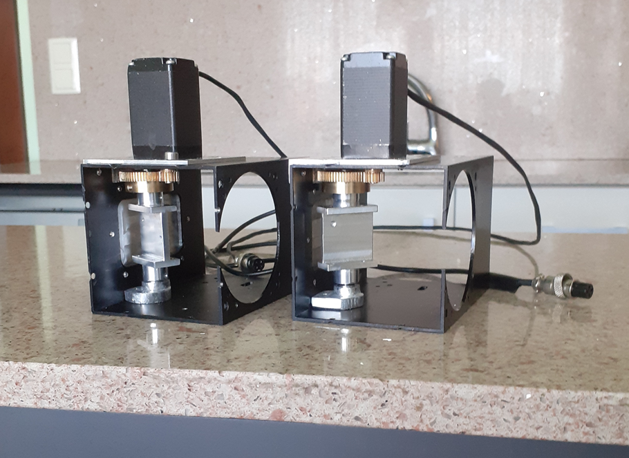

- Posts: 731
As you can see in this picture, the mechanical aluminum pieces for adapting 2 gratings in both Linx low-resolution spectrographs are
ready to send them for anodizing in matte black.
It was a laborious process, fortunately, not difficult.
If all works well, the two LINX will be the first low-resolution spectrographs that permit changing their two gratings via the internet.
Cheers, J. Guarro.
Cheers, J. Guarro.
