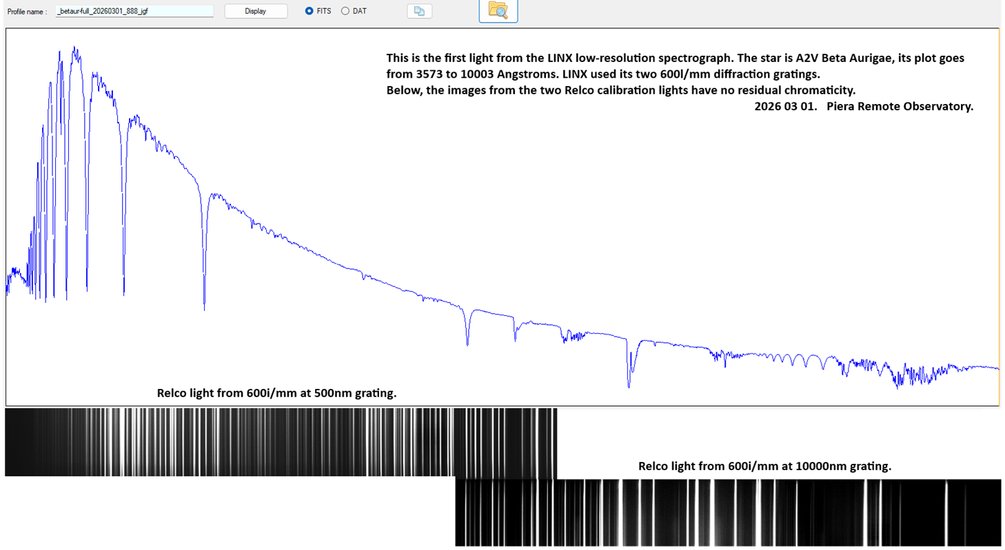

Finally, I can show you the LINX first light. I hope to show you more of them in a few weeks.
I hope you like it.
Regards. J.Guarro.

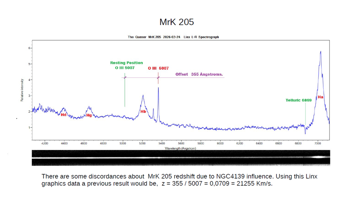

Re: Linx, a Low-Resolution Spectrograph Project
You can see some more LINX results here.
The next step is to try to know what the LINX edge is with a 16-inch SC telescope.
Regards, J.Guarro.
Regards, J.Guarro.

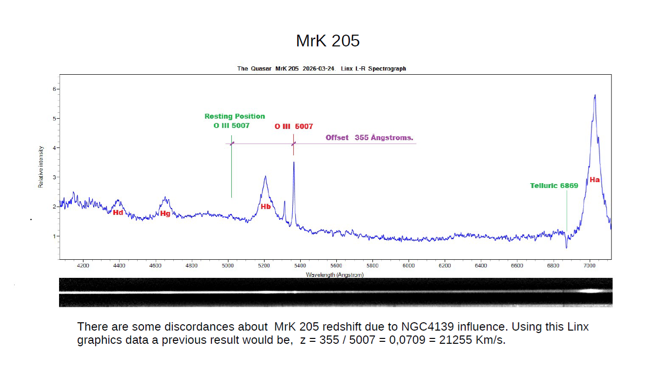

- Posts: 729
You can see here two new results of the LINX Low-Relolution Spectroscope.
I hope you like it.
Cheers, J. Guarro.
I hope you like it.
Cheers, J. Guarro.

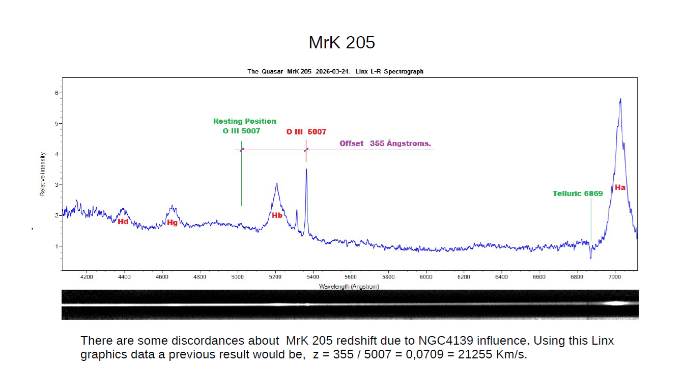

- Posts: 729
the Linx low-resolution spectrograph gives very good results, I want to show you this example.
Cheers, J.Guarro.
Cheers, J.Guarro.
