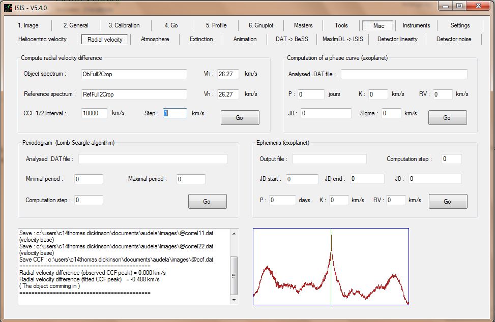

We are interested in using the Fourier Cross Correlation (CCF) functionality that is built into ISIS v5.4 under "Misc" --> "Radial Velocity" --> "Compute radial velocity difference" to analyze our Tau Bootis spectra and build a deltaRV curve to try and determine the exoplanet's orbit.

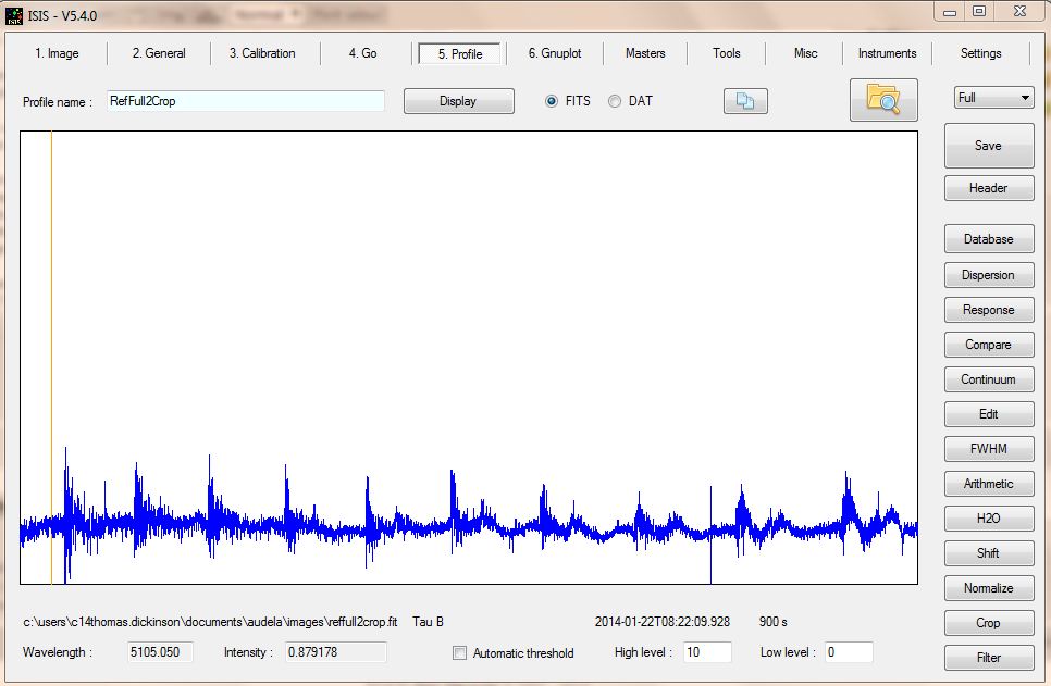

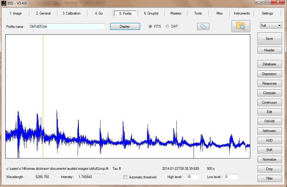

Two weeks ago we took two fifteen minute spectra of Tau Bootis one after the other and processed them in Audela to get the "B" plots that give intensity as a function of wavelength from about 5000 Angstroms to 6500 Angstroms. When we use the CCF functionality in ISIS to compare the two spectra it gives us a -0.715 km/s radial velocity difference from the CCF peak, when we expect is should be less than 0.100 km/s in magnitude given that the two spectra were taken one after another and the planet has an orbital period of 3.31 days. Cropping the two spectra down by about 5% on each side to remove some of the "noisy" looking data gives an improved Radial Velocity difference of -0.488 km/s, but if it could be lower that would be ideal.
I have attached screenshots of the CCF with ISIS and of the two spectra being compared. We are thinking that the discontinuities between orders caused by Audela stitching orders together (the periodic groups of spikes seen in both of the spectra) is throwing off the CCF, and we are wondering if there is a good way to remove these or lessen their negative effects. Any suggestions that are even remotely related to what we are doing will be most appreciated!

First is the rather poor S/N. The precision of radial velocity measurement is directly related to S/N, so this would be the first point to start with. I do not know the telescope you are using, so it is difficult to say how much you can improve there.
Second, the flats and the corresponding instrument response are not ideal, I had to work about this a lot. In my case it was related to poor alignment of the fiber guide unit. Better results for instrument response may be obtained by the order by order method (see notes on echelle calibration).

For the analysis it is no use to calculate the CCF over such a large interval, 100km/sec is enough, with a finer spacing. Try using the part of the spectrum with best S/N (possibly calculating RV for diffferent orders separately and averaging afterwards). Exclude regions with telluric lines.
