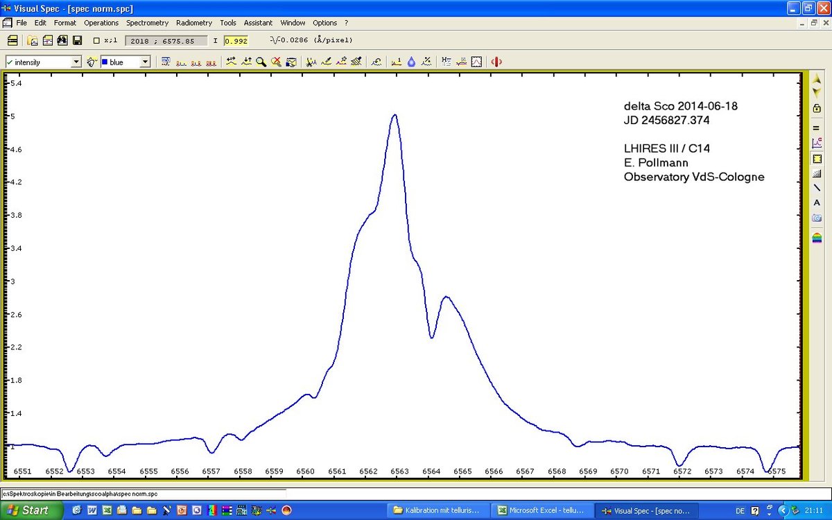

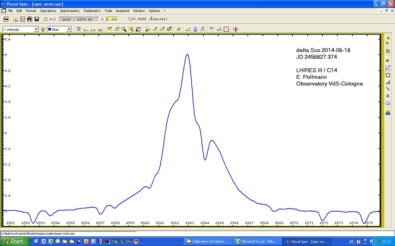

Hi Christian,
the current Halpha peak profile feature of delta Sco particularly between 6561 to 6564 might be interesting because of a possible ring formation of the disk. I assume you will observe that profile further?
My attached LHIRES III spectrum does show it too.
Ernst
