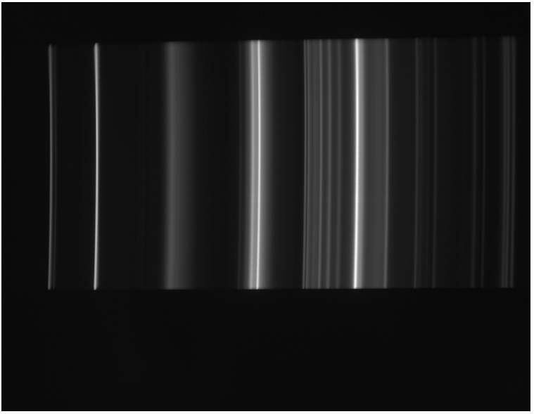

Doing exactly the same, having only ~500 resolution too (via Alpy cal.lamp + ISIS v5.4.1 wizard giving this value).
All I can achieve is having better average focus on a wider field (edge areas still blurred - that got focused only when middle is out of focus...).
Using a Landlite 15W "A class" energy saving lamp.
I can turn the core element +-45 degree angle but don't see visually any difference to my old setup (with ~500 res.) - except the up & down borders less blurred.
Interested in the same problem.
- Landlite A class 15W
- landlite.jpeg (18.2 KiB) Viewed 4821 times
