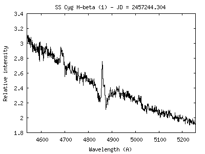

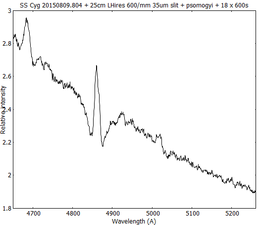

Re: SS Cyg
And the H-beta part of the next evening (18 x 10 min):
Merged every 2 exposures due to noise (9 x (2 x 10) min):
Processing here was tricky, "wavelength register" feature misbehaved, had to work it around (ref.star was processed only at final stage, with some extra manual work in IRAF needed).
Enjoy!
