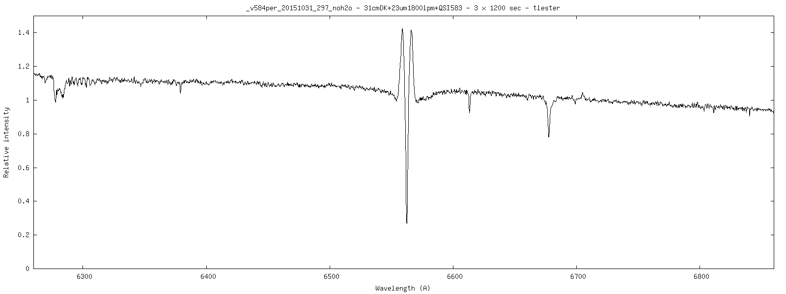

I took V584 Per on Oct 31st - its been submitted but not validated yet. Here it is with the telluric H2O lines removed.
