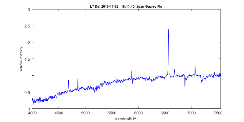

We have only one Spectrum in the base http://www.astrosurf.com/aras/Aras_Data ... /LTDel.htm
obtained by Joan Guarro

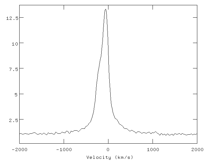

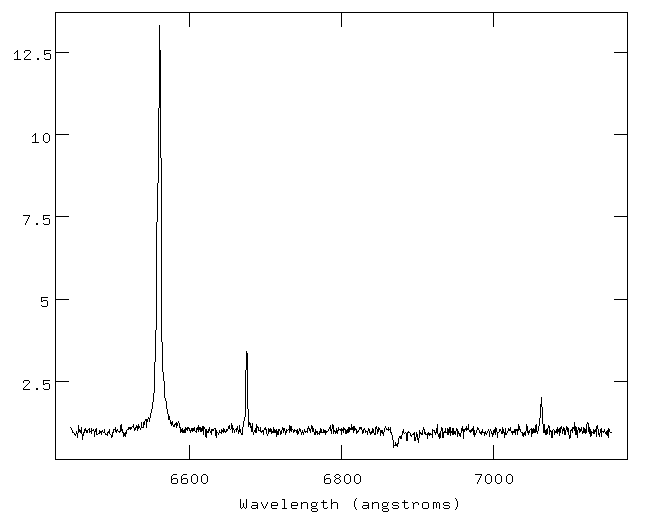

Fresh result from yesterday sunrise:
LT Del, 2017.05.11.078
3 x 20 min + 300/1200 Newton + Lhires III + 600/mm + ATIK 428 EXm + 35 micron slit, R~2700
H-alpha just getting resolved - even visually getting nicely separated on the raw image: The left peak was decreasing a very little from exposure 1 to 3.
However, there was not much else on this coverage, and the usual He I lines (6678, 7065) remain thin: Cheers,

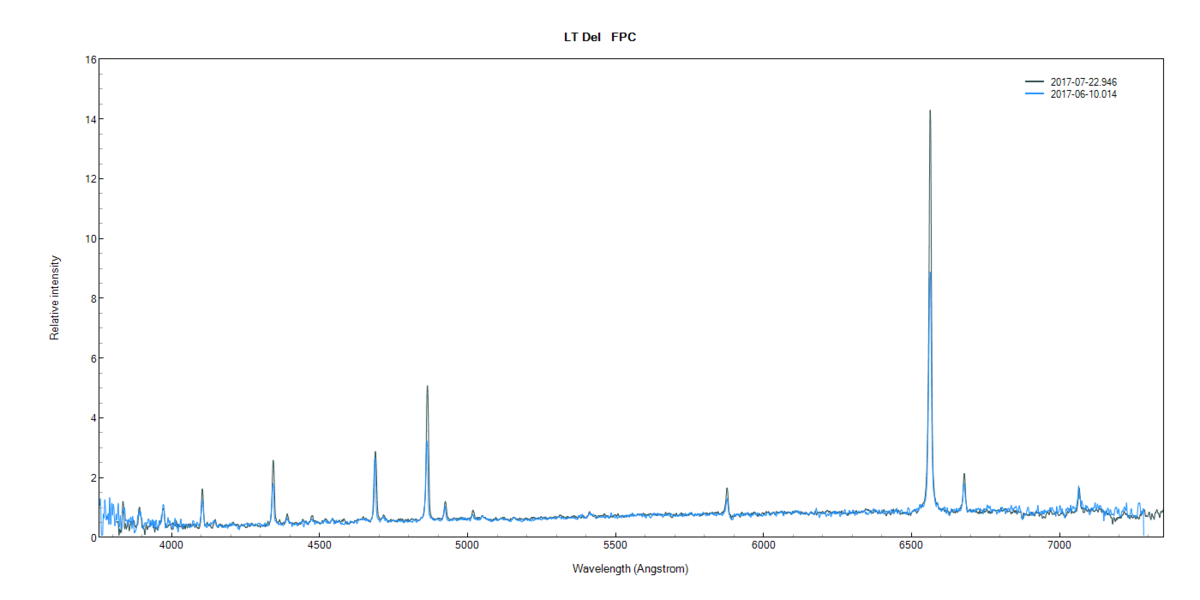

Re: LT Del outburst (ATel)
a fresh spectrum from the last night, with full Moon and sparse clouds, but still profitable. Comparing this spectrum with Joan's one, looks like that LT Del continues in altered state, showing intense He I and He II emission lines.
Greetings
Fran
Greetings
Fran

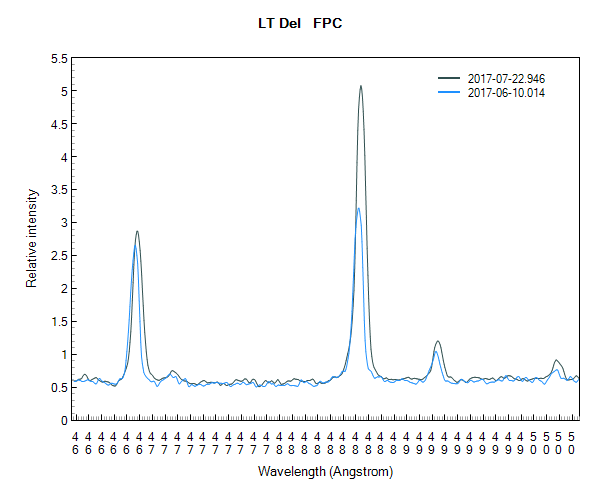

LT Del continues in outburst and the last spectrum I took last night shows a strong intensity increment in the Balmer bands. He I at 5876 A is also stronger but He I (6678A) and He II (4686 A) remain practically unchanged.
Interesting...
Greetings
Fran
Interesting...
Greetings
Fran
