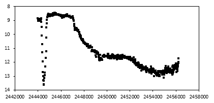

Excellent, the LISA is well tuned
and correct identitification of the lines. You have also the second Raman OVI at ~ 7080.
On such a spectrum, you can estimate the electronic temperature from [OIII] lines
Yes, it a symbiotic star and more precisely a symbiotic nova (1979)
Very long plateau maximum ~ 8 years before decline and a deep eclispe just after the outburst
The reference catalog for symbiotics is
https://aas.aanda.org/articles/aas/pdf/ ... /h2255.pdf
A little bit old (2000) but still very usefull
The composition of the system is still subject of discussion
