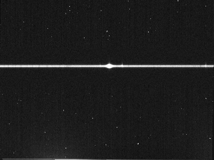

Re: Observation request: T Tau early in January
Is anyone else seeing evidence of the emission in the spectrum extending beyond the star (seen here above the stellar spectrum) or is it some aberration in my system
EDIT: It appears to be genuine nebulosity in emission as it inverts after a meridian flip
- _T Tau.jpg (43.96 KiB) Viewed 22565 times
Last edited by Robin Leadbeater on Sat Jan 03, 2015 11:29 pm, edited 1 time in total.
- Posts: 578
Hi Robin, this is my stretched 2d spectrum (after combining 2 jan frames) taken through a C9.25 f/10 telescope. I have very faint "smears" in correspondence with the emissions. I happened to see them (visible on both sides of spectrum axis) in other faint target spectra but I thought they were caused by star oscillation along the slit axis during the exposure (bad seeing, too faint guide star image).
- Posts: 578
I realize that my spectrum seems wider (in Y direction) and telescope focal length is lower respect to your setup, so the lines may be hidden.

- Posts: 1955
Hi Paolo,
Perhaps it is localised in a particular direction. In which direction does your slit run (mine runs in north-south) ?
After two bad nights here, conditions tonight are of course perfect and I have been running continuously for 7 hours now at 5 min cadence. A pity it is a day too late
EDIT: It seems the emission nebula surrounding T Tau is well documented eg
http://adsabs.harvard.edu/abs/1950ApJ...111...11H

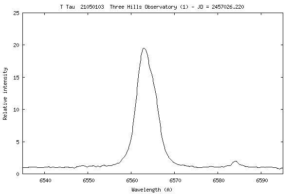

- Posts: 191
I took a series of relative short exposures of this star last night before I was clouded out using my LISA at R=1500 aprox.
What do I do with the fit files. Is there someone I need to send them to?
Terry

- Posts: 578
Hi Robin, thank you for info! That is very interesting! So there is an irregular nebula that begin from T Tau and extend several arcseconds. My slit axis has ~ 90 degree position angle (E-W direction), so it could be another problem to see nebula spectrum.
Very nice spectrum Terry, congratulations. I'm waiting for the same your question...

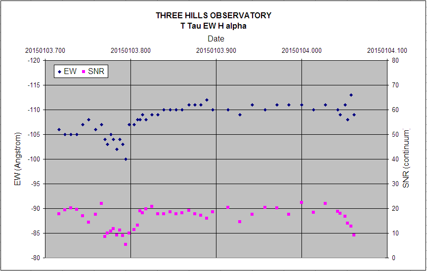

- Posts: 1955
An animation of 8 hours of continuous observation at R ~5500 and 5 min cadence from 3rd Jan and a plot of the EW. There is some variation, though the lowest EW point coincides with a period of lower SNR due to thin cloud.
