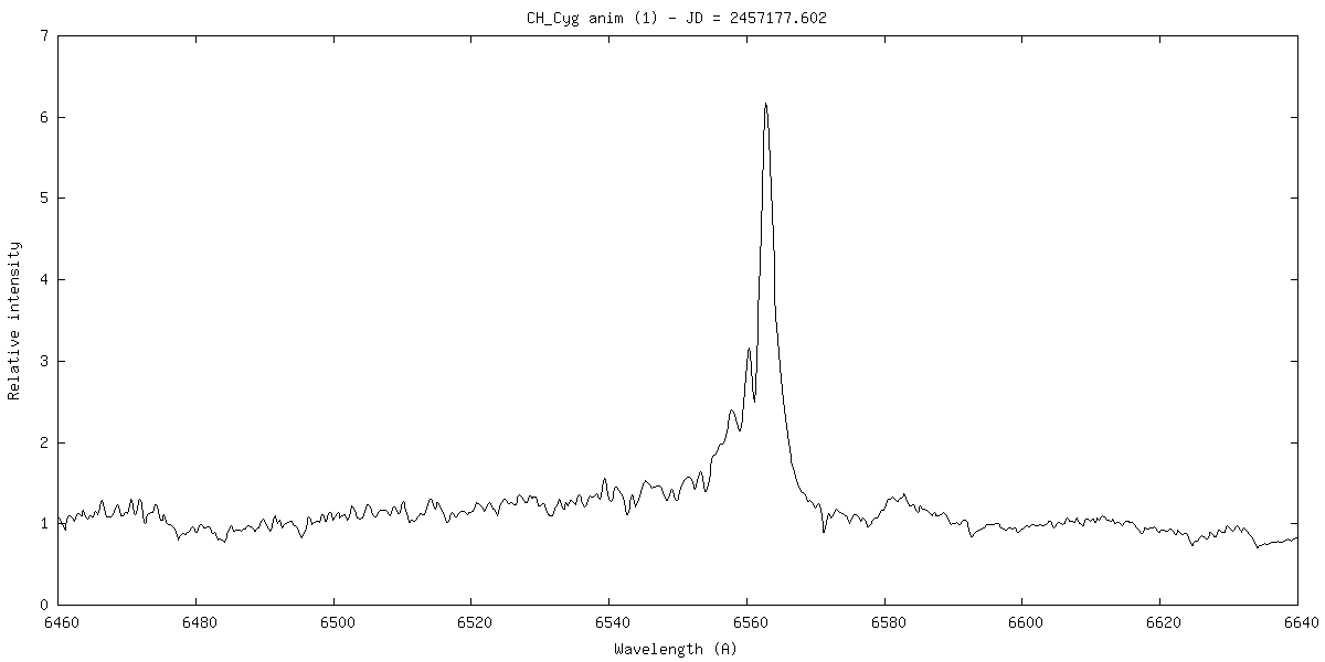

I did a series of 5 min exposures from 2015-06-04_101 to 04_255.
37 exposures in all with one break between exp 20 and 21 to re-focus and take new standard and cal exposures.
I think the region of Ha is flickering a small amount all the time on a time scale of just a few minutes.
Here is an animation of my series. Normalization was over the range 6600 to 6620 A.
