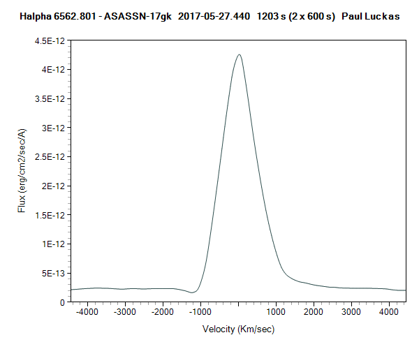

An update (click to enlarge):

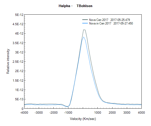

Impressive Paul.
I only have 2 spectra taken due to crappy weather.
Terry
Re: Bright nova in Centaurus
Posted: Sun May 28, 2017 8:59 am
by Paul Luckas
Hi Terry,
Nice work. Like you, I also managed some simultaneous photometry last night. I used my transformed V-band image in ISIS to create a flux calibrated version similar to yours. I think it serves to provide a useful comparison.
Paul

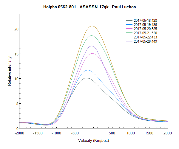

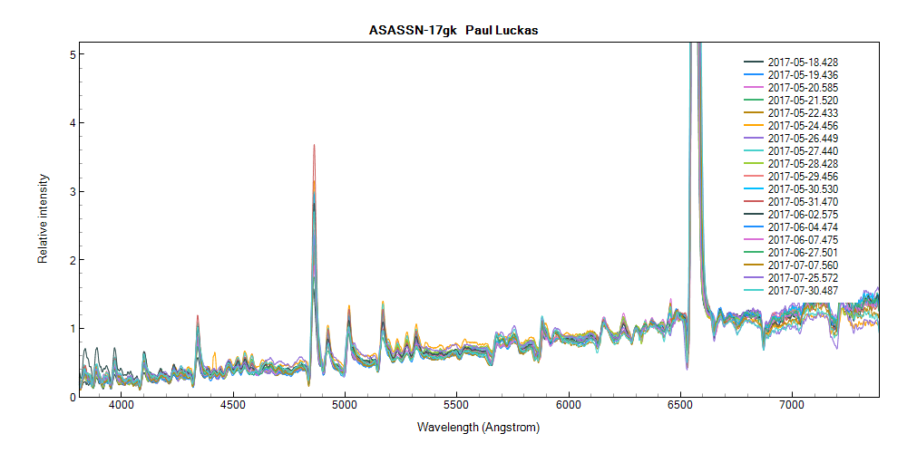

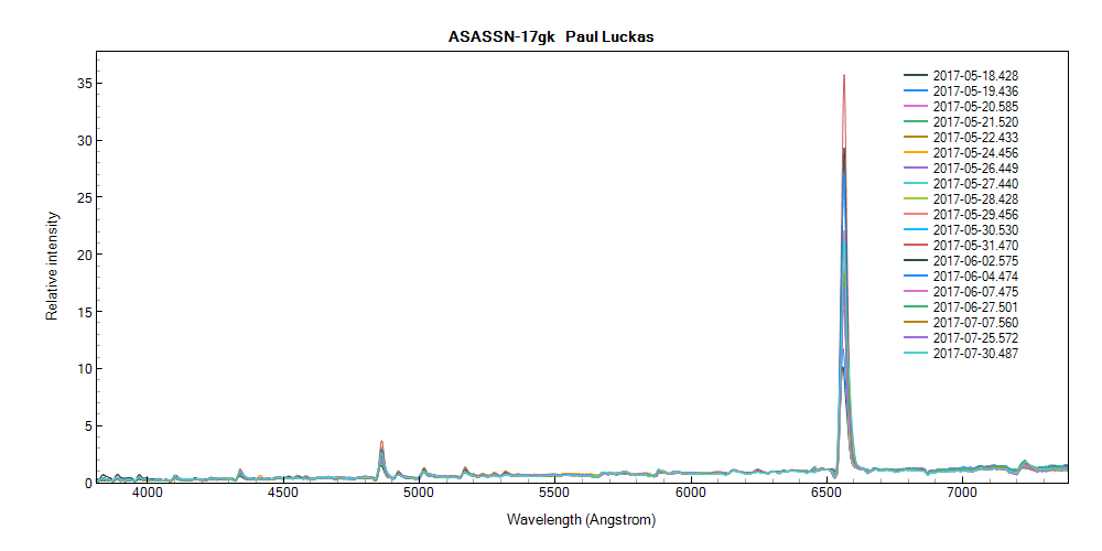

Aside from oscillating hydrogen emission lines, there's still little change noted in ASASSN-17gk (Nova Cen).
Paul
asassn-17gk_20170518_428_Paul Luckas.png (40.02 KiB) Viewed 9484 times
asassn-17gk_20170518_428_Paul Luckas 2.png (90.22 KiB) Viewed 9484 times
Posted: Wed Aug 02, 2017 9:05 am
by Olivier GARDE
Hi Paul,
Great serial spectra...
