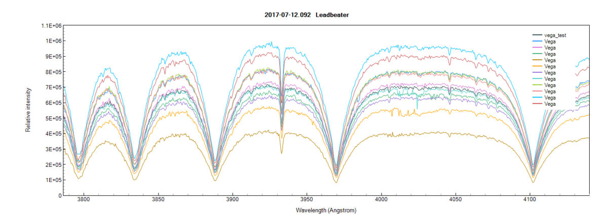

I made a quick test but could not find the bug here (win 7 64 bit) Attached is my xml file in case you can see a different setting
_vega_test_20170712_092_Leadbeater.zip
(1.24 KiB) Downloaded 382 times
Re: ISIS 5.9.0 available
Correction !
Yes I do see the same bug ! (Vega was the name of the previous run, vega_test was the name of this run)
