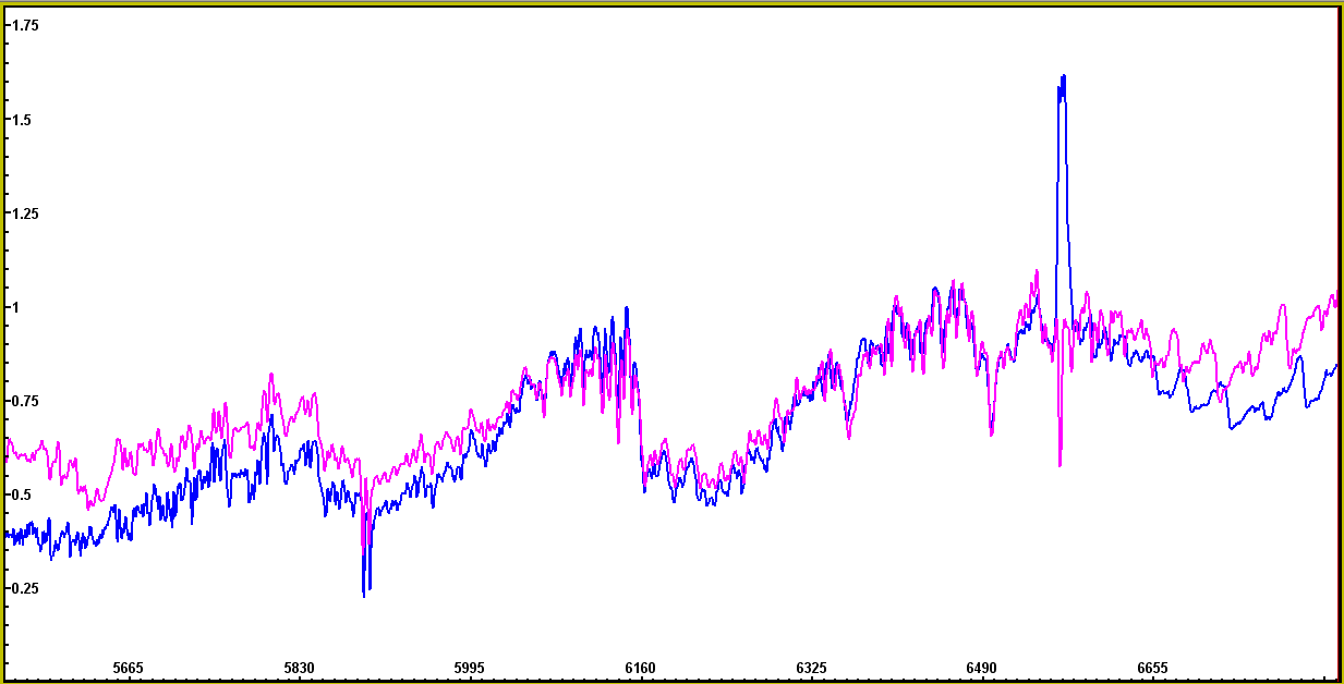

The original poster has made an important point though which affects all measurements of EW. To measure the EW of a line you need to establish where the continuum lies so you can measure EW relative to it. This needs to be done in a systematic, repeatable and reproduceable way. The problem here is that at this resolution we do not see the continuum. The overall shape you are removing here are actually bands of very fine unresolved molecular lines. If these change in intensity your pseudo continuum, and consequently your EW will change even though the strength of the line you are measuring may be unaltered. The solution is generally not to try to remove the continuum across the whole spectrum but to try to define a local continuum for the particular line of interest. Ernst has been plotting the EW of the H alpha line, perhaps he can describe the method he has been using in this particular case so others can replicate it.
Re: Questions to the campaign
Just let me add (without knowing how Ernst addressing the problem), in case you don't model and remove the M component anyhow (e.g. shoot mu Cep or Alp Ori and do the RV align), then the EW measurement will highly dependent on the coice of continuum interval selection.
My method was subtracting a well multiplied alpha Ori, usable only for a local place (short wavelength range) around a given feature set (because did not deredden for the whole range).
Determining the M ratio can be tricky, for the CaII region I was using an algorithm to detect that ratio automatically. At H-alpha, such a problem (B comp. almost negligible) less prominent than in the blue where you get the EW dependent on the B+M light ratio.

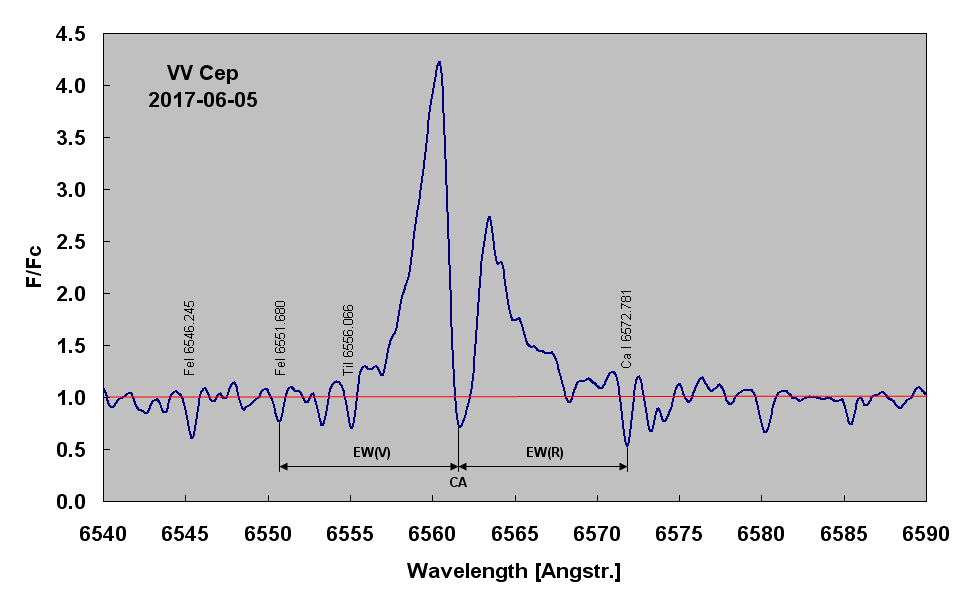

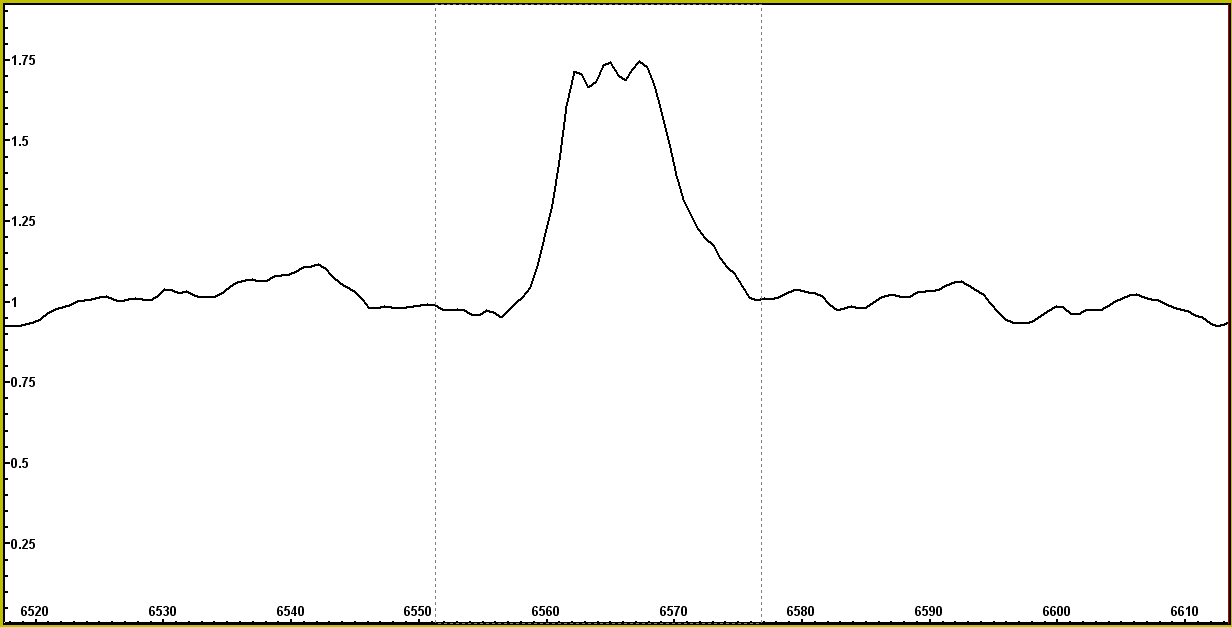

But first, I wanted to get information of the pseudo-continuum. That´s why I compared your (170927) spectrum with a flux-calibrated ones of the MILES data base (No. s0199, HD039801, spectral type M2Iab).
This comparison shows a well agreement in relative flux within the Halpha range. It seems there is no appreciable influence of instrumental response in that area. But of course, for EW evaluation it requires the process of normalization.
EW determinations have been carried out since 1996 always within the spectral section 6551 to 6573 A. To execute that, a normalization has been carried out always within the section 6540 to 6590, how it is to see in the Figure above. You will recognize that a certain (minimum) of spectral resolution is necessary to determine plausible values of EW.
I have zoomed the mentioned spectral range for normalization and EW determination as it is to see in the Figure above, in order to show, how this process has to be carried out in your low-resoluted spectra. The EW in your spectrum is - 7.5 A, but it should be -9.8 A compared with the value of the campaign monitoring.
In addition you can see that the Halpha emission shows a strange and unrealistic profile which is based in the too low spectral resolution. With other words: seriously EW determinations in such a sort of spectra are less to not meaningful.

in this case I used a smoothed spline function in VSpec after supress of the Halpha profil.
