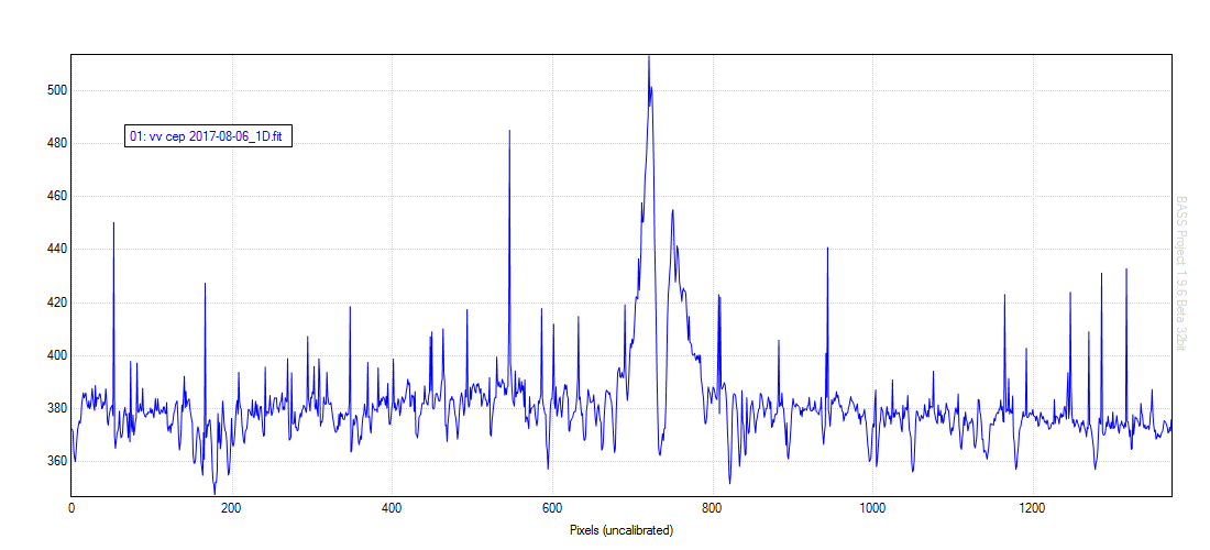

Jack Martin
- Posts: 54
- Joined: Fri Sep 11, 2015 10:31 am
Re: VV Cep this night
Ernst,
As Prof Shore suggested in 2015 at OHP vv cep lecture a 24 hour coverage by observers world wide.
A communication network, Skype link or Whats app could make it possible ?
I attach that 'quick' spectrum I could not load the other night.
I have not received a reply from my previous email so jackmartin781@gmail.com works not btopenworld the problem is at there end most frustrating.
Regards,
Jack
Essex UK
Regards,
Jack
Essex UK
- vv cep 2017-08-06_1D.png (52.33 KiB) Viewed 13611 times
