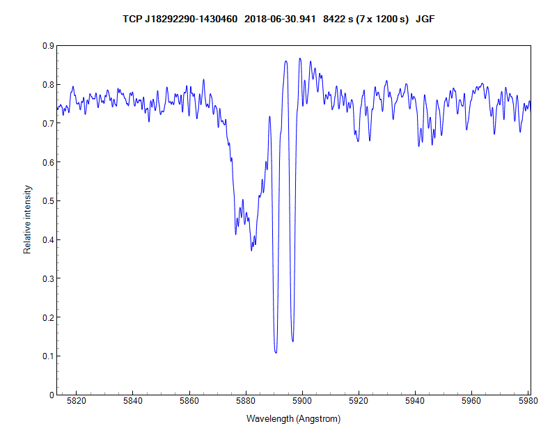

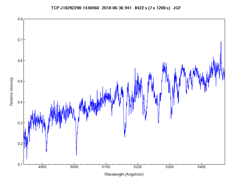

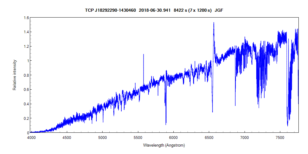

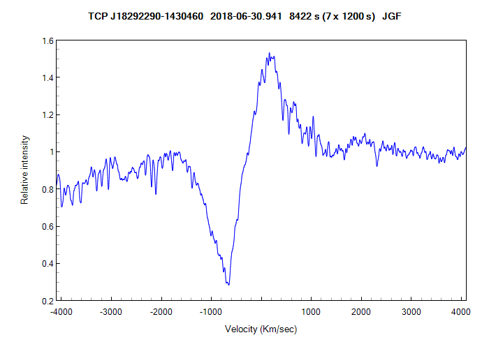

And quicky process, the graph of H Alpha velocity
And Sodium lines
I try to do more exposure to improve the SNR, (flux is very weak with an eShel)

In my graphics I have passed the filter, which has the ISIS, in value of 4 .. Attached the same regions that Olivier has also sent.
Graphics are cleaner, the question is. In which I have altered the results?
This is a good practice?

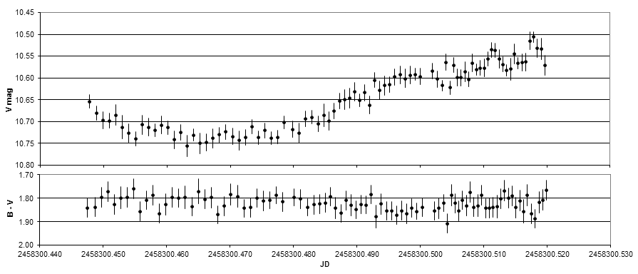

The following transformed B and V band photometry of Nova Sct 2018 was recorded with a 0.35m SCT between 22.44 and 00.29 UT on 30 June/1 July.
Nova Sct 2018 photometry 30Jun2018.png (14.61 KiB) Viewed 21112 times

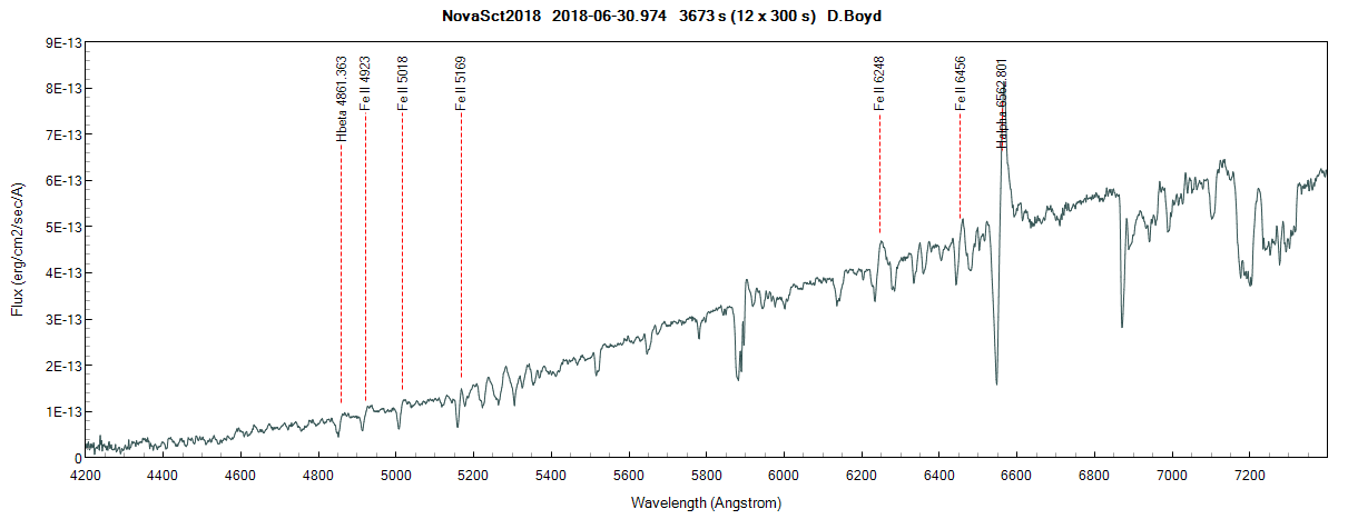

Spectra were taken concurrently with a C11 + LISA between 23.25 UT and 00.25 UT. R=1064. A mean V mag of 10.63 was adopted to flux calibrate the spectrum. As the average altitude of the nova was only 22 deg, atmospheric correction may be suspect.

David Boyd

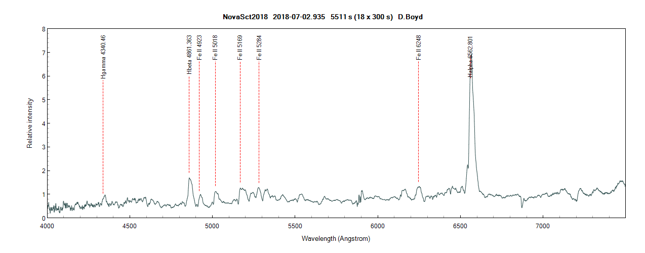

Large change in the spectrum of the nova since 2 days ago. H-alpha emission has grown and other Balmer lines now appear in emission while P-Cygni type absorption dips have almost disappeared. The continuum is now almost flat.
