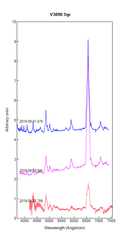

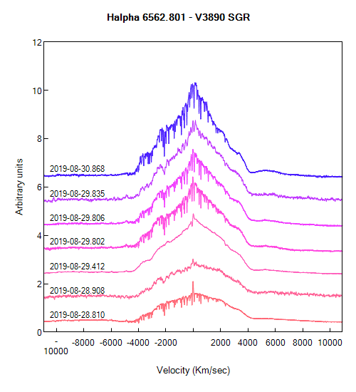

Merci beaucoup François, je dois féliciter Joan pour son fabuleux spectroscope fait maison.
La nuit dernière, j’ai encore regardé la nova, le ciel n’était pas dégagé, voici le profil, le graphique du V.R. et une comparaison avec 28-08-2019.

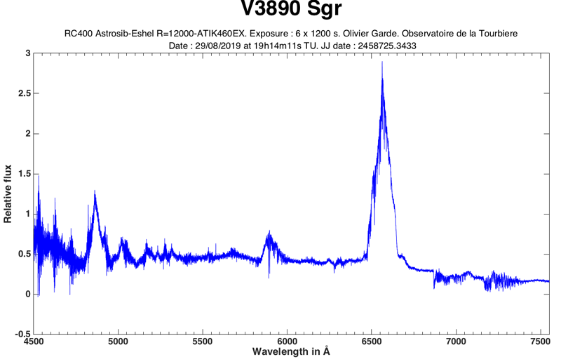

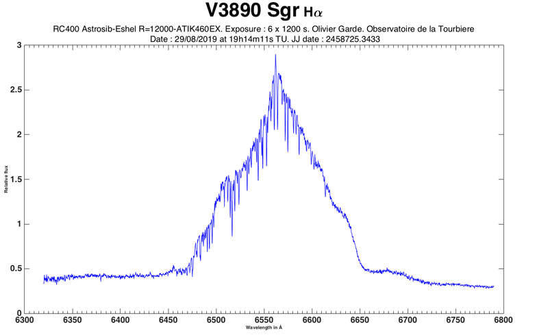

Here's my contribution with my eShel spectrograph. From my home, the target is very low, so difficult to take a good spectrum.
The full spectrum (croped at 4500 Å because of the noise below this wavelength)
And H Alpha line with a resolution better than 12000

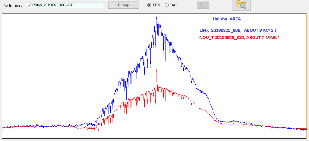

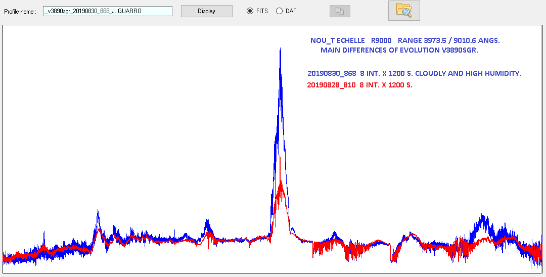

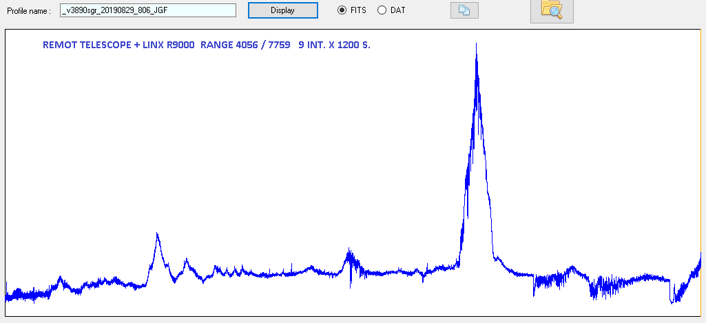

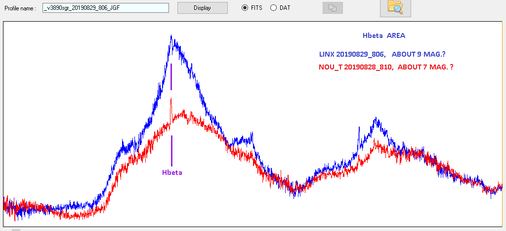

- Posts: 729
Re: Eruption of recurrent nova V3890 Sgr
Hello al,
Good result Olivier !
Unfortunately yesterday Piera was cloudy and I didn't can used the NOU_T, but the weather was fine in Sta. Maria, so I was observed V3890 Sgr with the LINX echelle. There are the results. Both cases have a long time exposure.
Robin, I have this star about 20 degrees above the horizon, that means an important atmospheric estinction with a remarkable humidity sometimes in Piera, in Sta. Maria it's another thing..By the way, I think I've had a little of lucky..
Regards, Joan.
Regards, Joan.
Ah yes of course they are mostly just Telluric linesJoan Guarro Flo wrote: Robin, I have this star about 20 degrees above the horizon, that means an important atmospheric estinction with a remarkable humidity sometimes in Piera, in Sta. Maria it's another thing..By the way, I think I've had a little of lucky..
Thanks

- Posts: 729
V3980 Sgr results again.
Joan.
Joan.
- _3V3890SGR.png (26.34 KiB) Viewed 12755 times

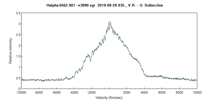

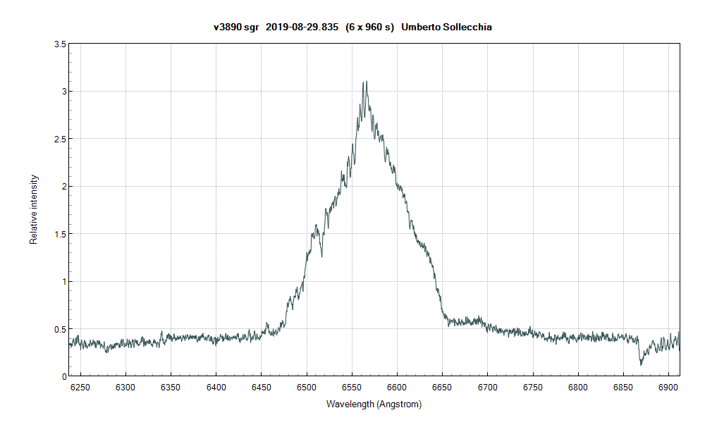

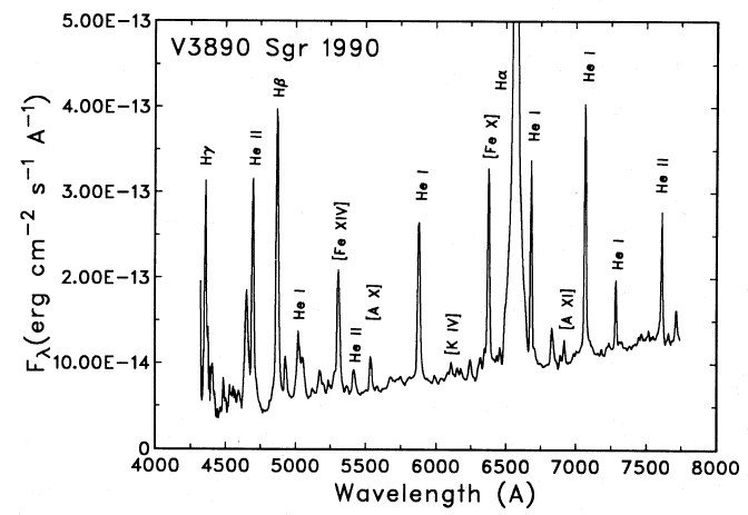

- Posts: 1567
The nova is declining quickly, as expected.
But the slope seems to weaken a little bit. Evolution with low resolution Spectra
Pavol A. Dubovski
Arlic G., Leveque M., Souchu J., Nougayrede JP.'
Paul Luckas
H alpha Line
Joan Guarro
Umberto Sollecchia
Olivier Garde
A spectrum obtained 18 days after 1990 outburst
showing very high ionization lines [Fe X] and [Fe XIV], resp. 262 and 392 eV!
Of course further observations are very welcome until nebular stage
Bonne continuation,
Pavol A. Dubovski
Paul Luckas
H alpha Line
Joan Guarro
Umberto Sollecchia
Olivier Garde
Bonne continuation,
