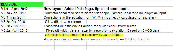

See your comment in the revisions for your SimSpecV4, highlighted here
Does this refer to a different way of calculating SNR based on a method from CAOS or just a modification of the spreadsheet calculation of SNR to take account of slit losses which was added in the same revison ?
Thanks
