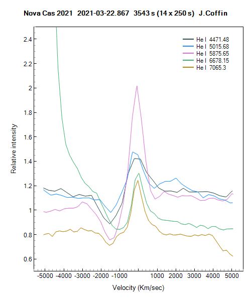

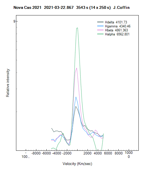

Hi everyone, here are some velocity plots from my Alpy spectrum from 22nd March.
- nova cas velocity plot 2203_ balmer.png (26.01 KiB) Viewed 15800 times
- nova cas velocity plot 2203.png (32.96 KiB) Viewed 15800 times
The wavelength calibration of my Alpy normally becomes more inaccurate at shorter wavelengths, this is something two other Alpy users have noticed. The error causes a 2 Angstrom blue shift at H gamma.
Best wishes, John

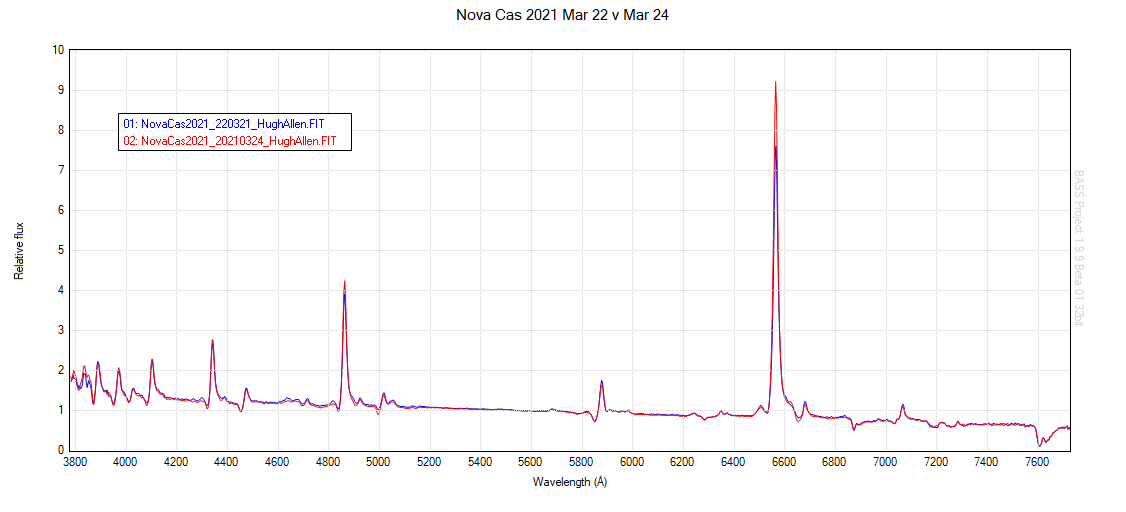

Alpy 600 spectra Nova Cas 2021: Mar 22 v Mar 24
Posted: Thu Mar 25, 2021 12:56 pm
by HughAllen
A comparison of the nova spectrum on Monday and yesterday evenings with my Alpy 600 spectroscope. If the visual magnitudes are assumed to be similar on the two evenings then an increase in the Balmer emission is visible with a small decrease in the HeI emission
Hugh
- Nova Cas 2021 Mar 22 v Mar 24.png (34.46 KiB) Viewed 15687 times

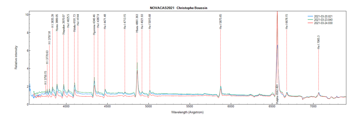

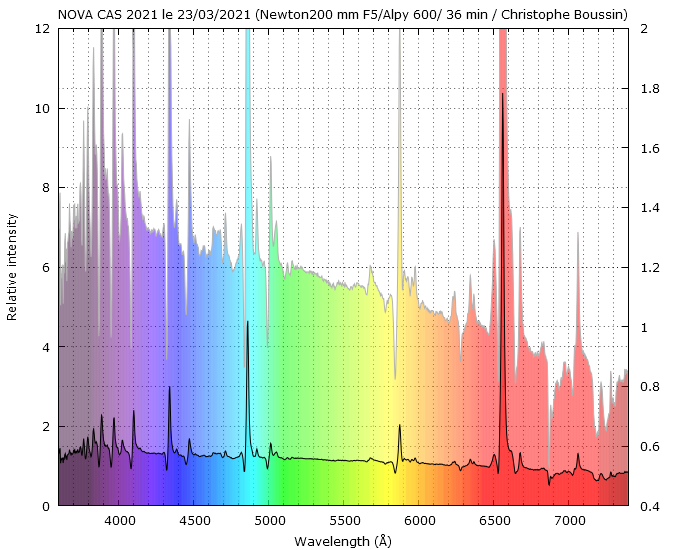

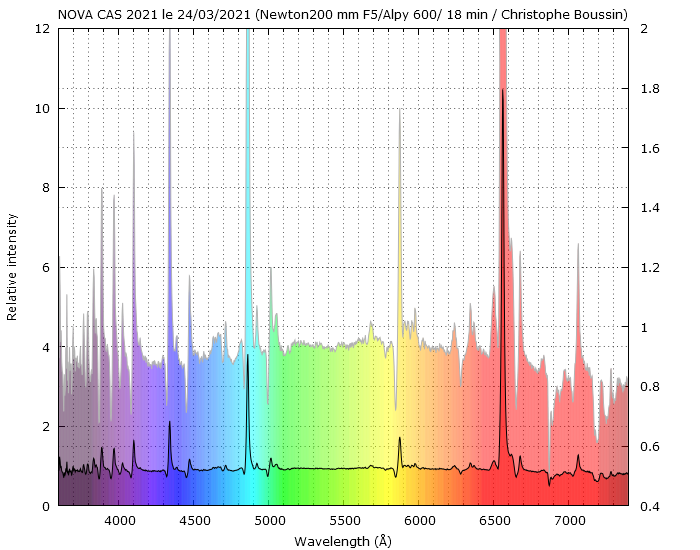

Here is my update for the monitoring of the nova Cas 2021.
The following spectra were obtained with my Alpy 600, respectively, the 23th of March at 20 h 10 TU (resolution of 525, JJ = 2459297.3404) with an acquisition time of 36 min (12 x 180s) and the 24th of March at 19 h 55 TU (resolution of 529, JJ = 2459298.33) with an acquisition time of 18 min (6 x 180s) :
- Nova Cas 2021 on March 23th, 2021
- _novacas2021_20210323_840_Christophe Boussin_3600_7395.png (96.19 KiB) Viewed 15575 times
- Nova Cas 2021 on March 24th, 2021
- _novacas2021_20210324_830_Christophe Boussin_3600_7395.png (84 KiB) Viewed 15575 times
- Nova Cas 2021 on March 20th, 23th and 24th 2021 (identification of some lines from PlotSpectra)
Clear skies,
